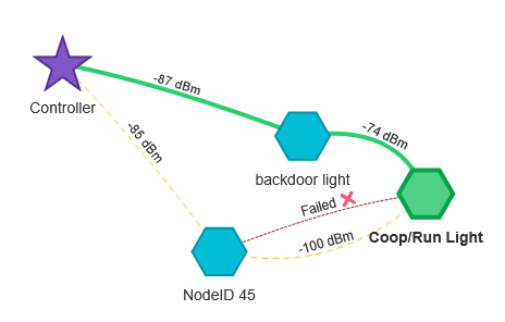

The network graph for this particular node shows that it’s routed through at least one switch.

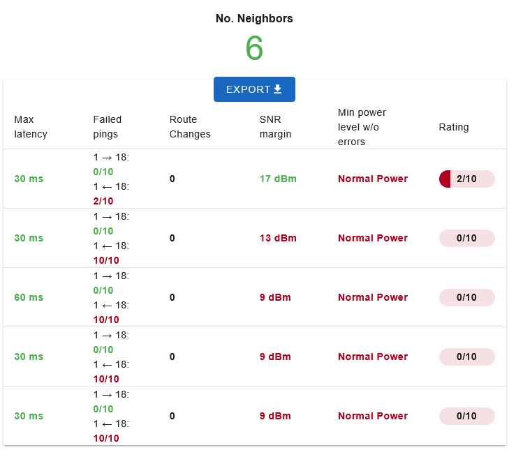

However, it seems that it has very poor connectivity (at least when it comes to relaying things back to the controller).
I’m not sure what to make of the numbers I’m getting, or what a “good” signal should be. So, I’m curious if anyone has any thoughts or suggestions to improve the connectivity.
hi, it looks like the SNR is too low, which means the switch is too far from the controller and its neighbours.
Any way you can improve the distance between the controller and the switch? Or any opportunities to add another zwave device that is closer to the chicken coupe?
One other idea - if the chicken coupe switch is in a metal box, see if you can replace it with a plastic one. Might help improve the marginal signal to something more reliable.

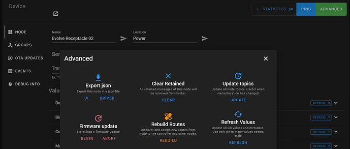

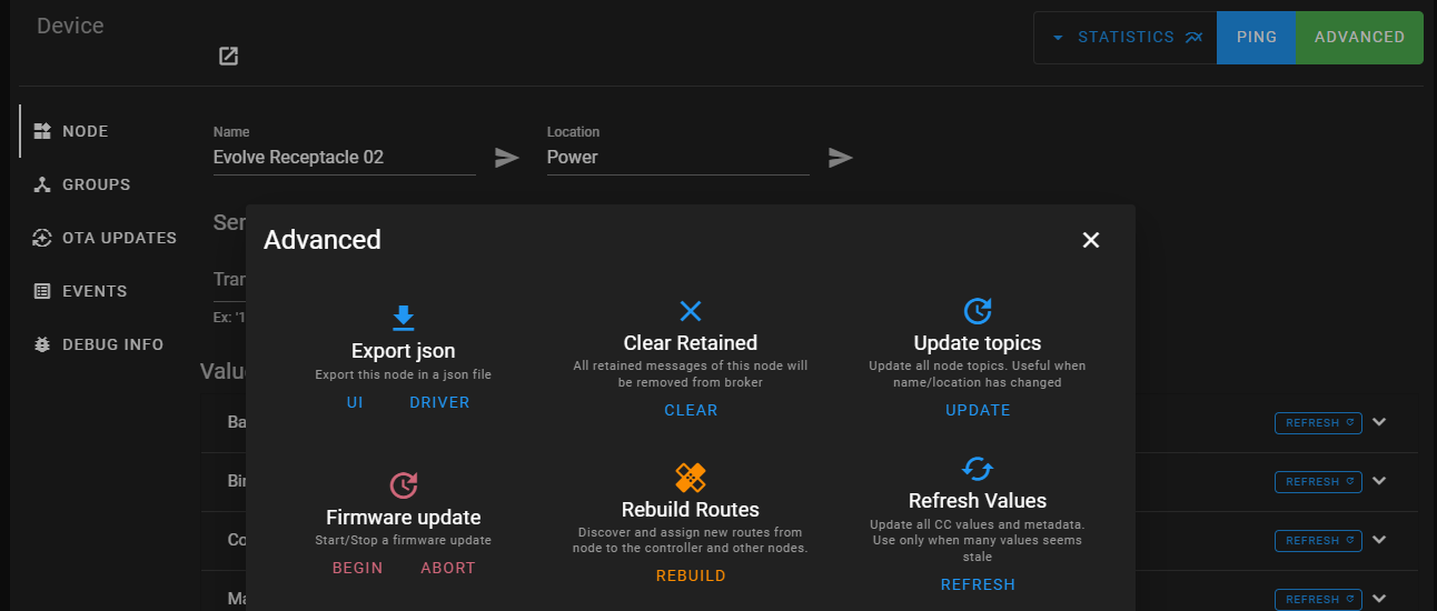

Here’s something I discovered lately after 2+ years of manually resetting the circuit breaker (with everything else attached to that circuit) for one of my Z-Wave sockets.
When my Evolve Receptable falls off the network I go to the advanced options and hit ‘Refresh Values’:
That seems to do the trick for my device.
I know, it doesn’t solve the annoying connectivity issue, but at least it might make an easy workaround.
