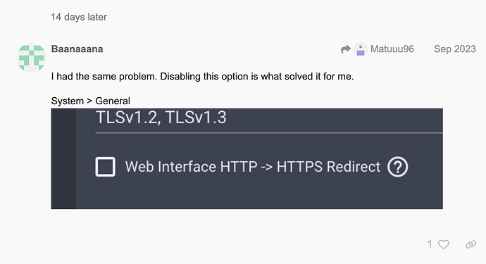

Actually, the problem seems to be linked to the SSL, it is now mandatory.
So now I am trying to understand how to add this.

Thanks this solved the problem for me too… :ok_hand:
