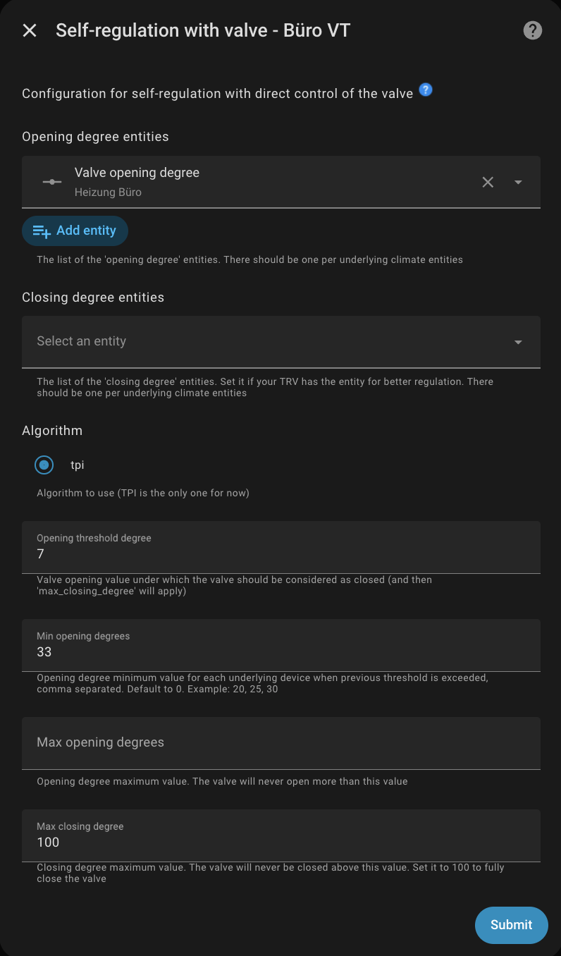

my question was more:
do we need also closing degree in Sonoff TRZVB and why.
As you see in the image i only have opening degree set.
Ai told me that Sonoff TRVZBs can have problems when closing degree is also set and it is enough to set opening degree as this can fully steer the trv.
So i dont see why we need closing degree and if this would change anything.

The blueprint you use, I do not know what it does, and still not sure about what you are solving.
I can confirm that both opening and closing degree is working. I can also confirm that it will “drift” a little over time, hence a static number might not help you. Has to do with your usecase.
I do not use closing_degree. I have them on 100% all the time. The valve will open, to the full opening_degree, when heating is needed and close when not. All my TRV’s have a different “percentage” where the radiator actually starts to heat. This is due to the mechanics of the setup.

I recommend reading the Opening / Closing Degree documentation carefully (e.g. here).
My understanding:
If you were to set the opening degree to 30% and leave the closing degree to 100%, the valve internal on/off control would still operate and regulate the valve only between these thresholds (will not physically open to more than 30%, but will fully close). The movement range in this case is 70% of the full range.
When you set the opening degree to 30% and the closing degree to 70% you allow the valve to only operate within a 0% range. This basically overrides /disables the internal on/off control and you keep the valve open to that desired position (30% in this case).
