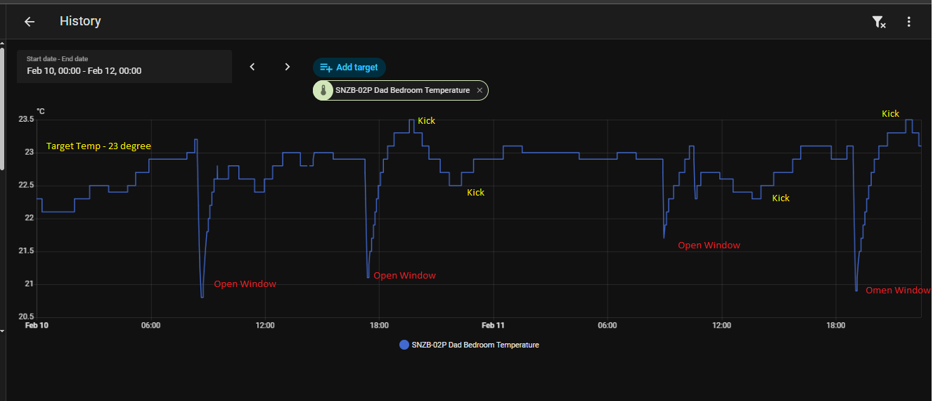

For me the new adaptive mode is working amazingly well, compared to better thermostat the amount of overshoots have been gone.
Maybe it is just working well for me because I use external temperature sensor, syncing with HA automation.
Better thermostat example:
