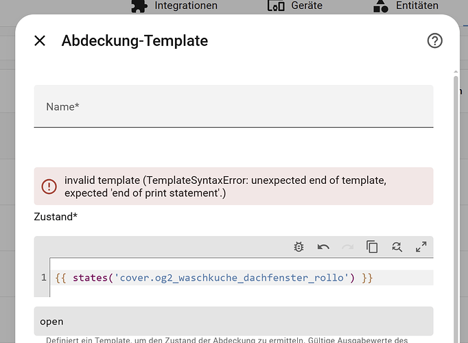

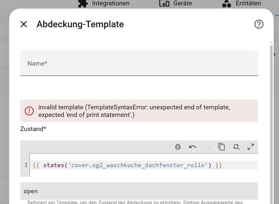

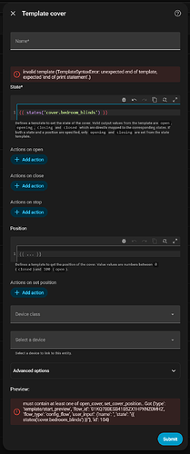

Try to make a template of type 'cover'
whats worng here? Test is ok, but syntax is wrong?
Thanks for helping out
Tht one looks ok to me. Are there any more templates defined below?
no
But can’t find any relevant samples to show how to set up a temlate cover. The documentation includeed isn’t very elpful.
What do you want the template cover to do? You already seem to have a cover entity to get the state from? The template can for instance used to create a cover from e.g. switch entities and sensors to detect end states. What do you have in Home Assistant that you want to look like, and control like it is a cover?

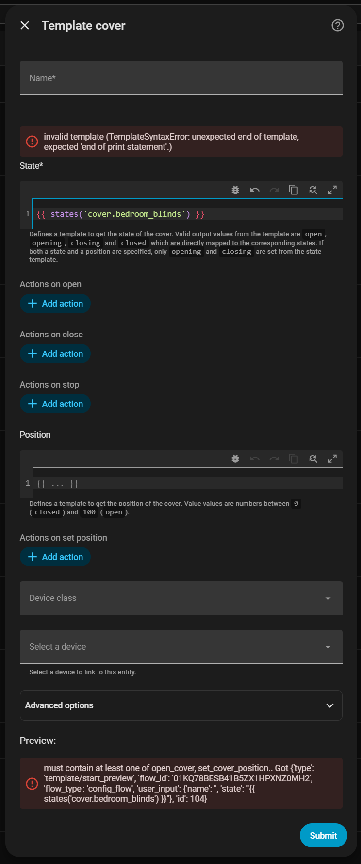

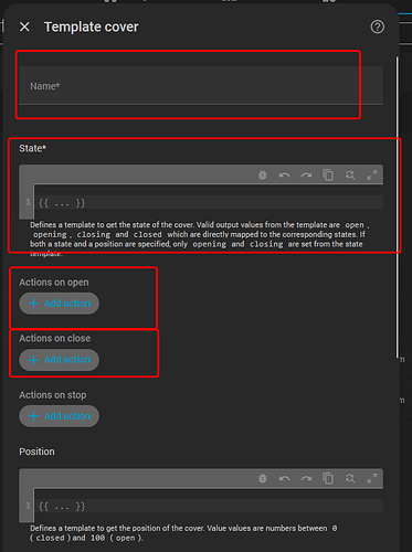

I get the same if you only put that line in, look right at the bottom of the dialog and it says it needs more

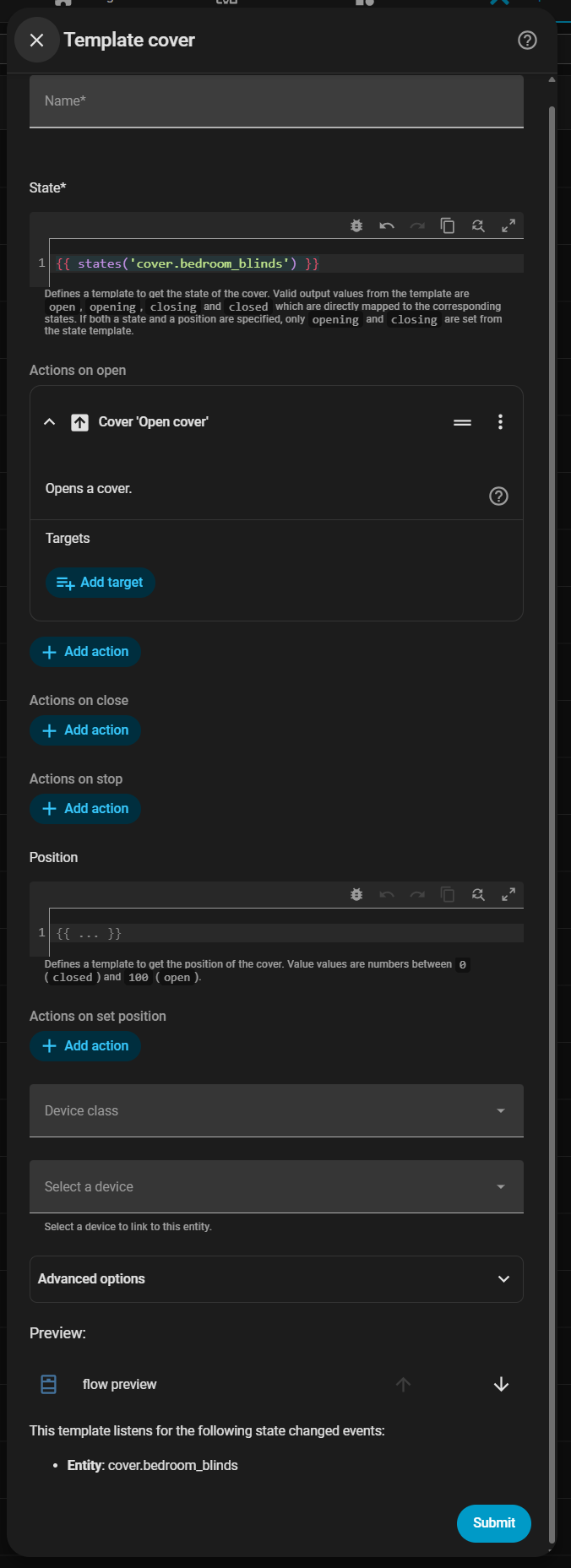

Adding an action:
I have a roof window plus blindes and the both shouldn’t collide, if possible.

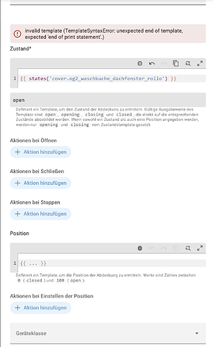

Yes, found out that you get error messages during typing … ok, this isn’t reeally an errpr, because work isn’t done so far. Ok, accepted
Now I havee the probleem to set the position. I only want to hand it over, no changes for now. Docu says its calles ‘position’, but no idea how to note it down in yaml, tried lot of syntax, nothing works.
      position:  {{ position }}
Didn't work, for example
You’re missing quotes around the template.
      position:  "{{ position }}"

Oh, yes, now it works
Where is the yaml code of this templates stored?, have seven window/cover combinations and with the UI tool which produces phantom errors, it is tedious ,
UI does not store yaml.
Oh my god. So no chance to get this template working.

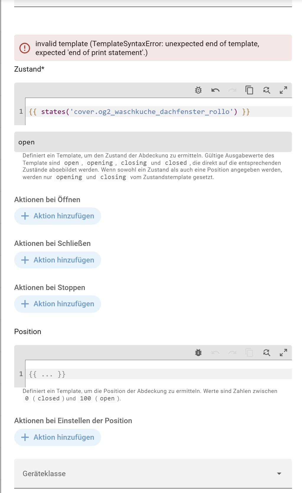

Problem:
I managed to have one, but with endleess ckicking, now as I know the result I want a second but get the error:
And I do EXACTLY the same as before.
I also get this errors at my first try, but after some clicking it works magically.
Is there another way to create a cover template?
Covers require an open and a close action. That’s non-negotiable with cover entities. You are not providing them.

Ok then, you need to provide the minimum to make a working cover:
  1. name
  2. state
  3. open_cover
  4. close_cover
If you need to have postion, then you also need to include a position template and set position
