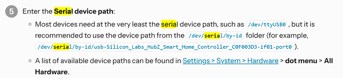

Go back to your Z2M config & change it to use the serial device path instead of
port: /dev/ttyACM0
Easiest way to do this is to unplug your ZBT-2, check Hardware page inside HA, then & plug it back in & see what changed. Chances are, you were probably targeting the ZBT-1 in your Z2M config.

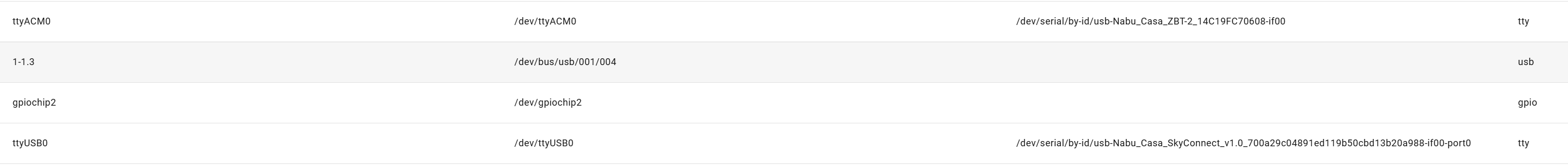

The hardware listing shows me this:
Which suggests the /dev/serial/by-id/usb-Nabu_Casa_ZBT-2_14C19FC70608-if00 setting is really the same as /dev/ttyACM0 anyway.
On rebooting the Zigbee2MQTT app shows “Error” on Settings->Apps, but there are no fresh logs in the zigbee2mqtt/logs folder. At this stage I go to the Zigbee2MQTT app and select Open Web UI which seems to be the only way to get a fresh attempt to connect and fresh logs. But under “Devices found” it only lets me set /dev/ttyACM0, it doesn’t appear to let me edit the configuration before trying to apply it, so when I submit the config it changes it back to /dev/ttyACM0 and then fails like before.

Until you unplug one of your USB devices or reboot the server running HA & the devices get detected in a different order. Safer to use /dev/serial/by-id/ & avoid the possibility of this happening altogether.
That makes sense, I have made the change as you suggest
