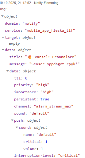

Also, it looks like data is double, and idk how to fix that:

  • How do I avoild the double-data sendt in the last node?

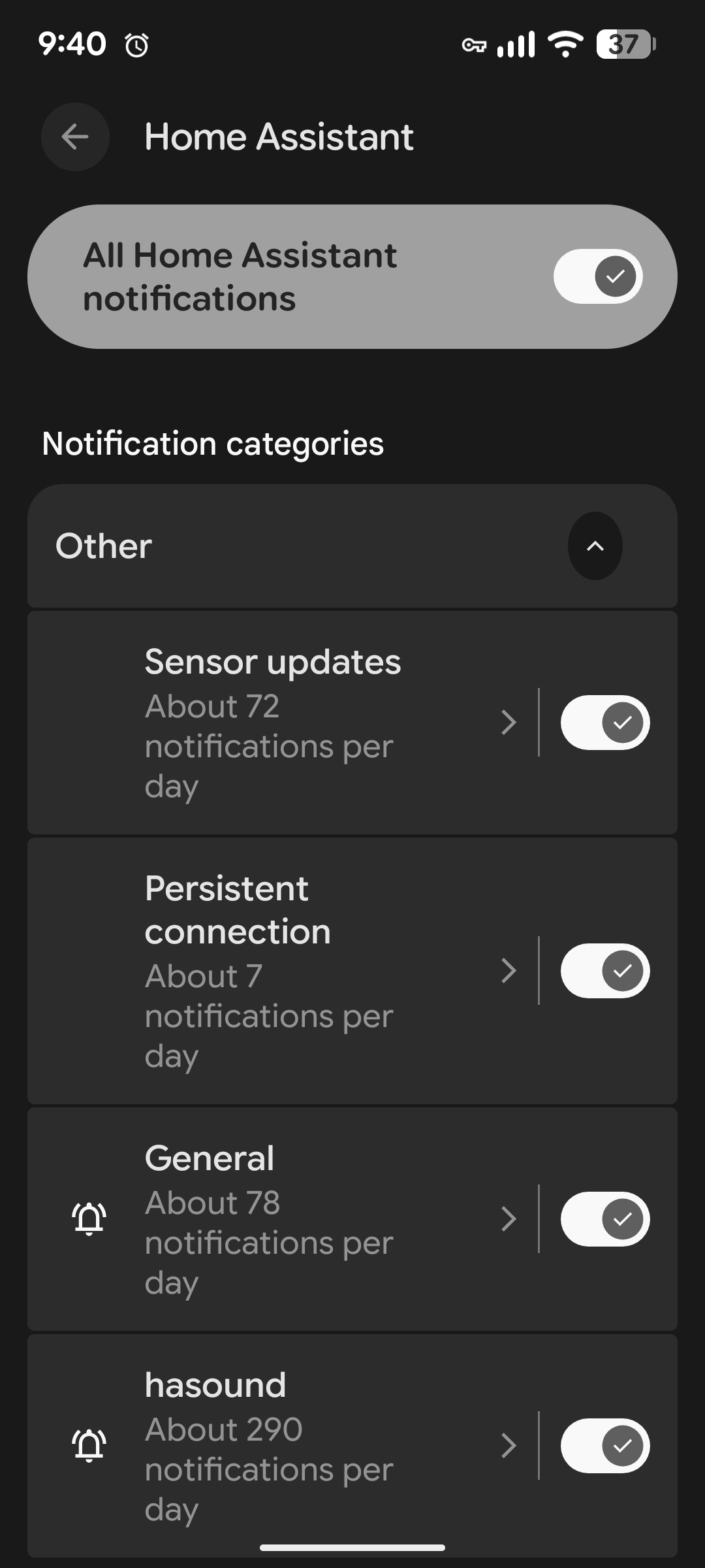

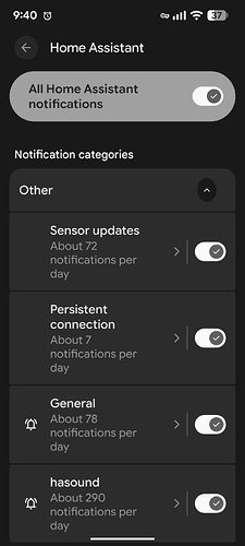

channel: sets the channel’s ttl and priority setting to those set in the data. This is set the first time the phone receives a notification to that channel. If you long press the ha app icon and choose notifications, it will show all your channels.
clicking a channel like “General” or “hasound” will let you set the notification sound. Try creating new channel by using a new name. Once a channel is set to certain priority/ttl it cannot be turned up to higher level.

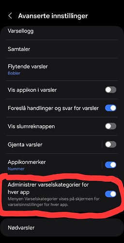

Can’t find That, this is my menu
Edit: IT had to be enabled

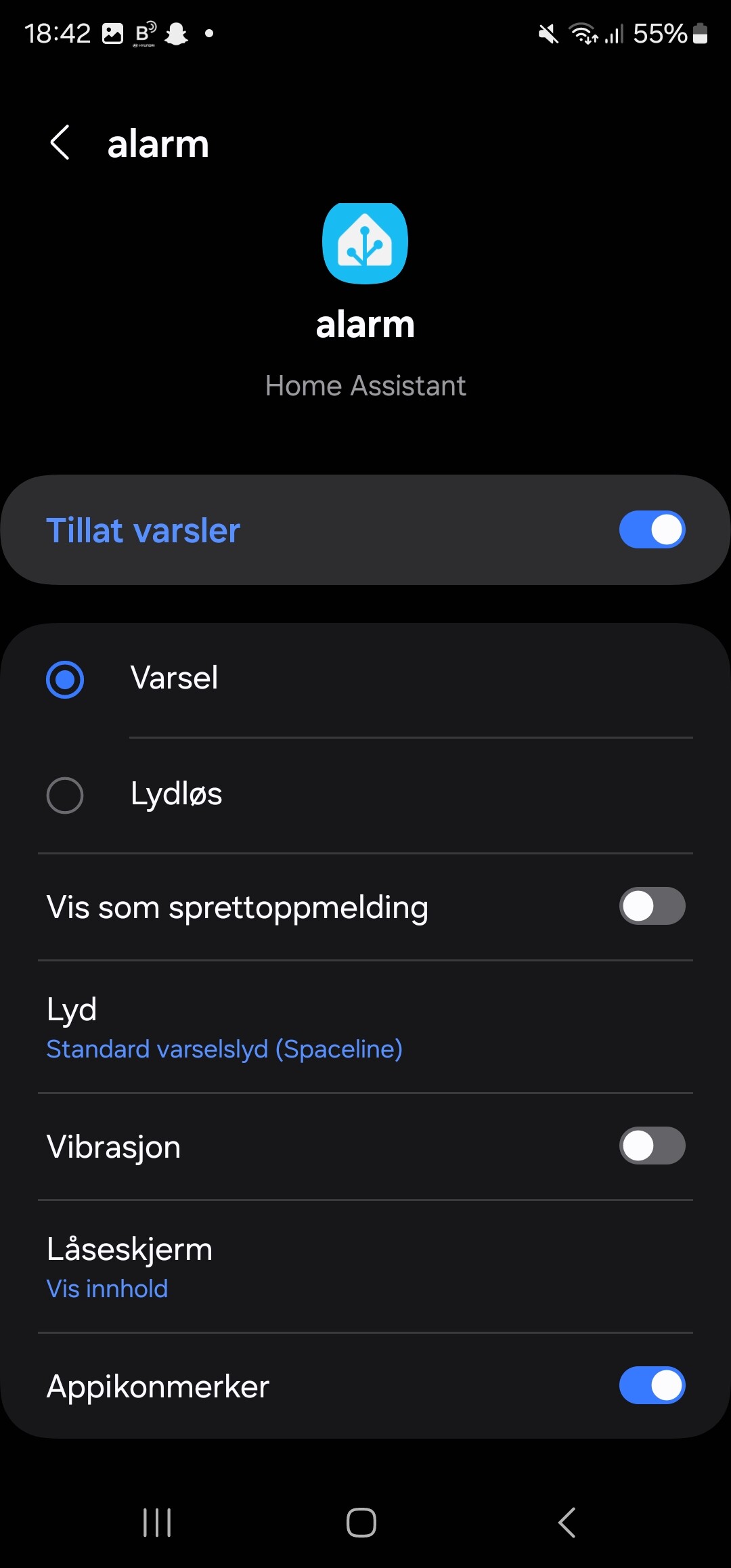

So, I made rhis, but still no sound, or on lock screen. Just acting as a normal notification with nothing extra.
    "ttl": 0,
    "priority": "high",
    "channel": "alarm"
I can only assume there is another setting that you need to change, that admin permission you needed to enable is not on pure android. Samsung adds a bunch of crap to the android os.
