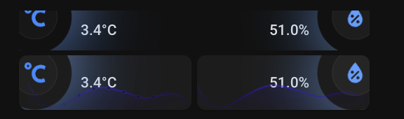

Trying to completely remove gap and background in grid card
I’ve been messing around with Anas Box’s Mushroom based animated cards and finally got it set up the way I like it. I want to have Temp and Humidity cards stacked left to right as shown in the screenshot below. When I took it the next step to add in the minigraph card via vertical stack in card, it ends up becoming a full width card and to have the line up nicely you have to place them in a grid card. But no matter what I try for the ha-card styling, I can’t seem to make the background as transparent as before and I can’t eliminate the gap for a seamless effect.
The screenshot shows each individual card on the top row of the section. The bottom row is the grid card. You can see how visible the gap is and how the background doesn’t blend as nicely into the background of the dashboard.
Here’s the beginning of my grid card YAML:
square: false
type: grid
columns: 2
card_mod:
  style: |
    ha-card {
      background: transparent !important;
      box-shadow: none !important;
      border: none !important;
    .grid {
      gap: 0px !important;
      row-gap: 0px !important;
      column-gap: 0px !important;
cards:
  - type: custom:vertical-stack-in-card
    cards:
Any suggestions or advice on what to try would be appreciated!
And if you want to paste the whole thing and troubleshoot from there here’s the full card YAML below:
