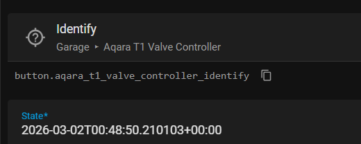

I have an Aqara T1 valve controller that sometimes becomes “Unavailable”. So I created an automation that triggers on that state. I also found that the “Identify” entity of these devices contains the last_seen value:
I’m trying to take that long date string and extract only the days, so I can use it in an automation to determine the number of days has elapsed. Below is one of my unsuccessful attempts. Can someone please show me how to convert this date stamp to days?

The Aqara T1 doesn’t have a last_updated entity. Not many entities at all. So I’m trying to use your statement with the last_seen which is displayed by the identify entity shown below.
The conversion is not working but it looks close!
-Thanks
Last Seen status is: "{{ ((now() - states('button.aqara_t1_valve_controller_identify') / 86400 ) | round(2) }}"

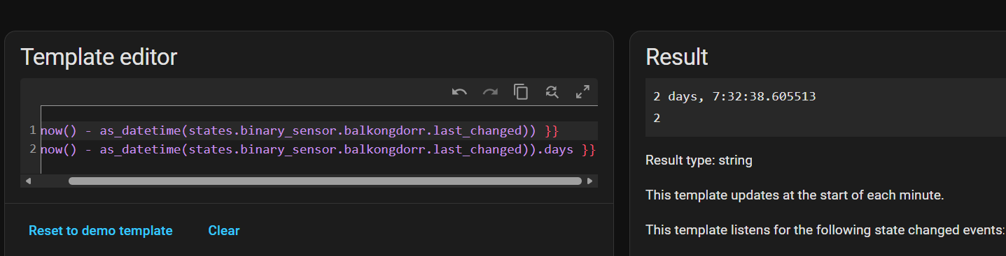

But most entities at least have the last_changed state.
{{ (now() - as_datetime(states.binary_sensor.balkongdorr.last_changed)).days }}
