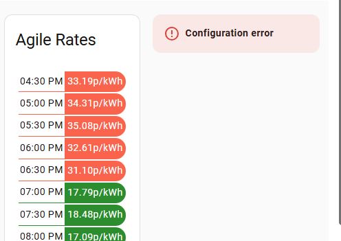

Trying to create a dashboard with dynamic times slots every 30 minutes
Hi All
Been trying to get this working for about a week
I have the octopus-energy-rates-card working fine and wanted to have a column of on-off buttons in a column to the right of the rates for the rest of the day which could be 11:00 at the point of opening the dashboard so I only wanted the right button column to align row by row and only show buttons from 11:00 this is so I can control 2 heavy usage appliances and Aga cooker and Immersion heater via wifi switches.
I just can’t get the dynamic button switches to work any help would be much apricated :slight_smile:
