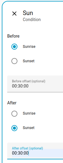

So,… Do I ‘logically’ read this statement as,…
Sun, condition Active , Before Sunrise, ( but offset ) by 30Mins
And
Sun condition Active , After Sunset, ( But offset ) by 30mins
… or do I need to create / write it as two statements to use an ‘or’ function
Thankyou for your help

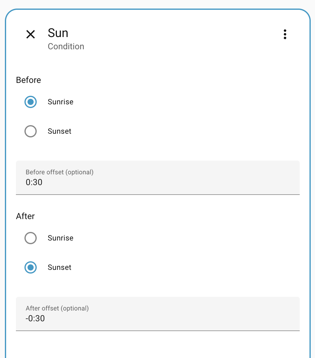

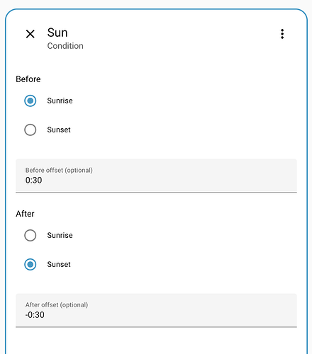

Based on your description you want:
      - condition: sun
        before: sunrise
        before_offset: "0:30"
        after: sunset
        after_offset: "-0:30"
For the sake of this explanation lets say that:
  • The sun rises at 06:00 (6:00 AM)
  • The sun sets at 18:00 (6:00 PM).
With no offsets it’s pretty clear, you want to allow the light to turn on:
  • Before Sunrise.
  • After Sunset.
The after_offset is pretty clear too:
  • If you set a positive value (0:30) it would not allow the lights to turn on until 18:30
  • If you set a negative value (-0:30) it would not allow the lights to turn on until 17:30 (5:30 PM).
The before_offset is confusing, but it actually work the same way as the after_offset, hence:
  • If you set a positive value (0:30) it would allow the lights to turn on until 06:30
  • If you set a negative value (-0:30) it would allow the lights to turn on until 05:30
David,… Many tx for explanation,… Trying to understand and second guess if you have it correctly configured can be a little painful,… but when it is verbally explained, for a working example,… it makes so much more sense…
And then gives one insight to move to the next level/task…
Again Many tx
