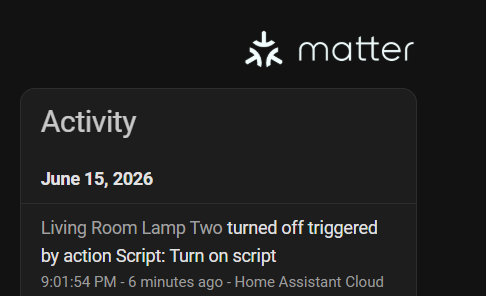

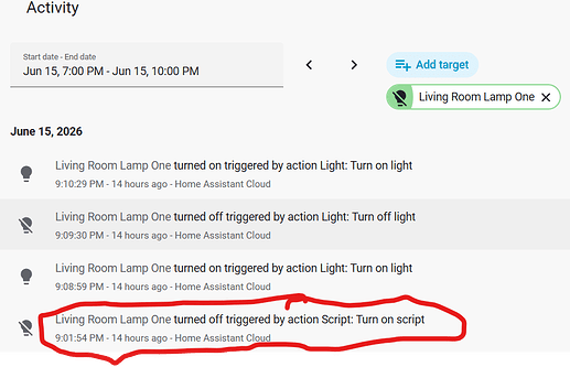

I was standing in my living room and suddenly both living room lamps turned off. I don't have any automations or scripts that turn off the lamps at 9:01 PM. Looking at the activity for both lamps it indicates "turned off triggered by action Script: Turn on script". Not sure what "Turn on script" means. I don't have a script by this name. I looked in the logs and there was nothing of interest around 9:01 PM.
Any idea how I could determine what turned off my living room lamps?

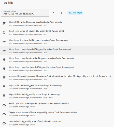

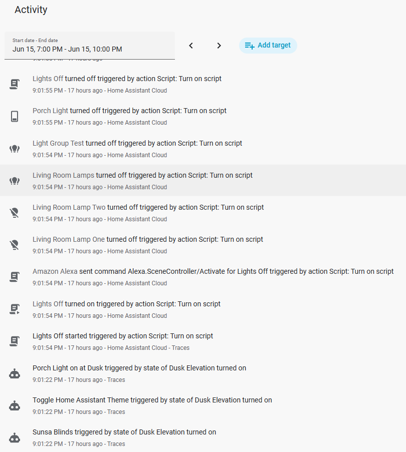

What I did finally was view ALL of the activity entries for 9:01 PM, not just the living room lamps. I'm sure the culprit is here somewhere!
-Thanks again.
It's right there in the picture you posted. Alexa Scene Controller command
Yes, it looks like my son inadvertently told Alexa to turn the lights off. He normally only controls his lamp and his printer.
