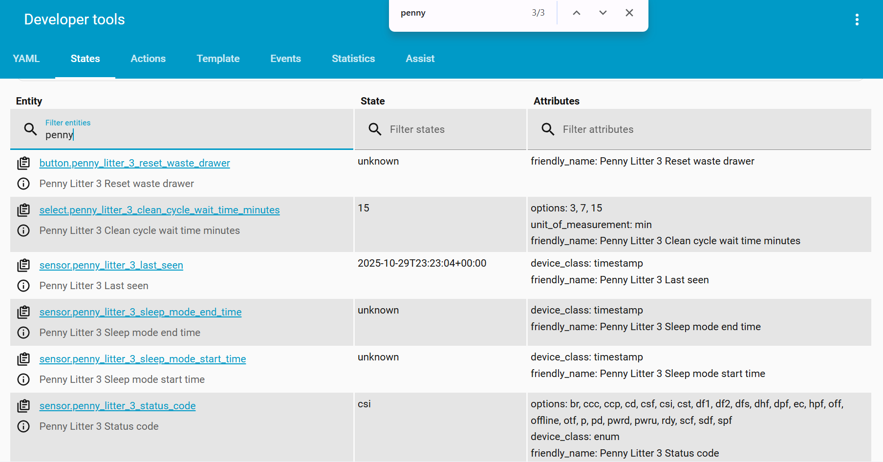

We need to see the yaml of that automation posted inside a code block </>.
And also from developer tools on that sensor when it has that specified error code.
It could be that the error code has a beautified state in the frontend, but what you actually need is something different

Status code is CSI
