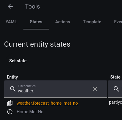

Search in the states tool for weather. to filter for just your weather entities. Once you find the right one, click the clipboard icon to copy the entity ID, then paste that into your template.
Thanks! Found it and discovered that humidity is not in the list of attributes. Had read it was. NWS also doesn’t have humidity. Now I am on a search for a relative humidity or dew point source.

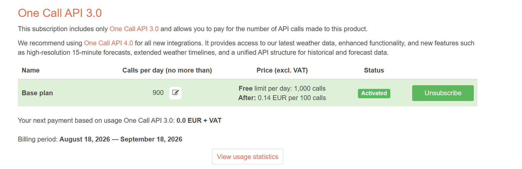

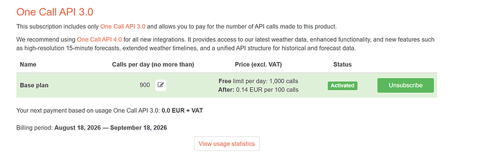

Have read that Open weather map requires credit card info for verification. Would rather avoid that.

Use a disposable card from Revolut & set the API 3.0 settings to something below 1000

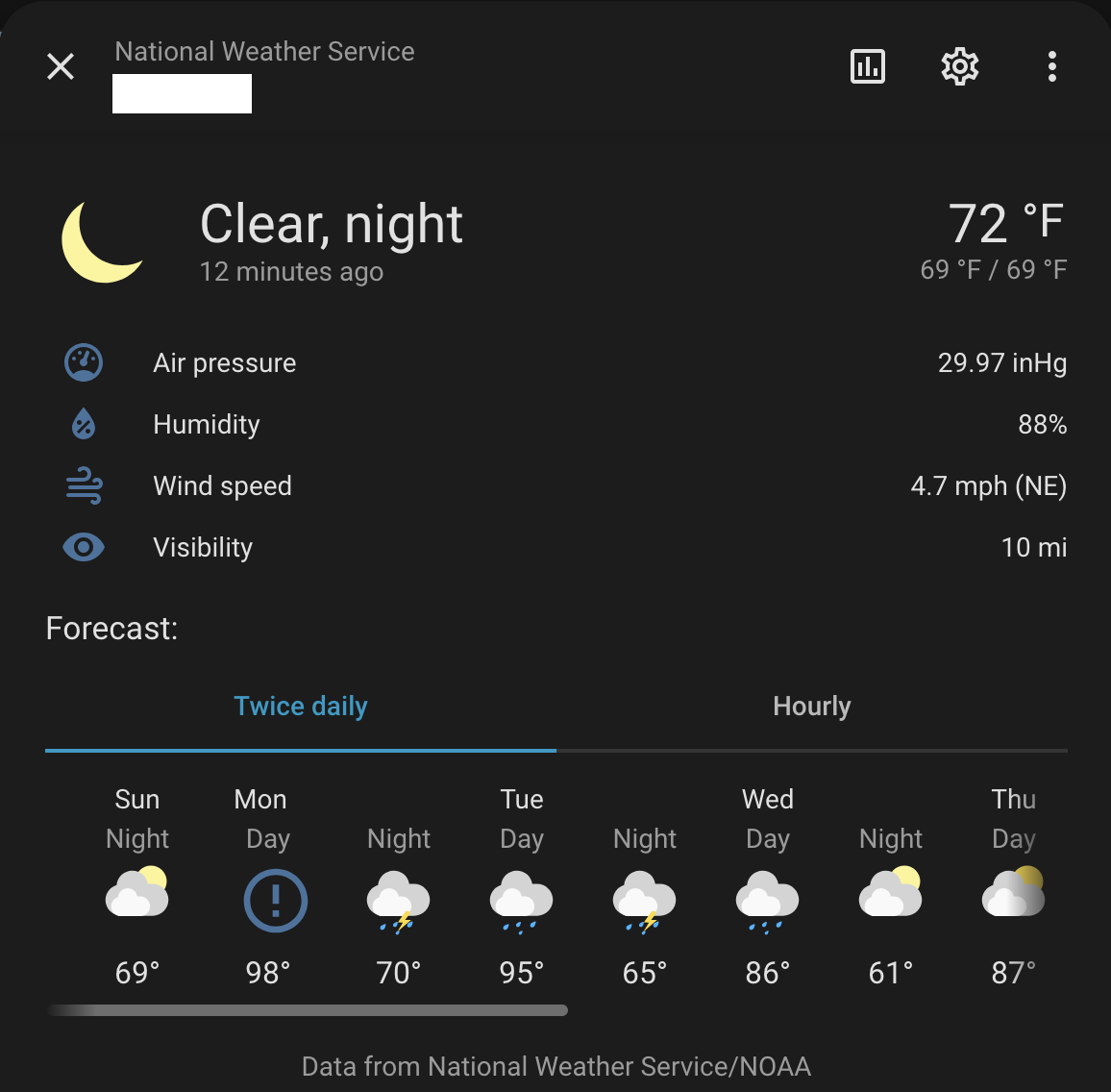

I use NWS (National Weather Service/NOAA) and mine has a relative humidity sensor.
Maybe it depends on location ? Or maybe the entity is disabled. If IIRC, I think I did have to enable it.
Mine shows relative humidity as one of the measurements available and I enabled it. But it doesn’t ever get a value. Some of the other values do populate so maybe this particular site doesn’t have it. I have a couple other NWS sites nearby so could try them.
