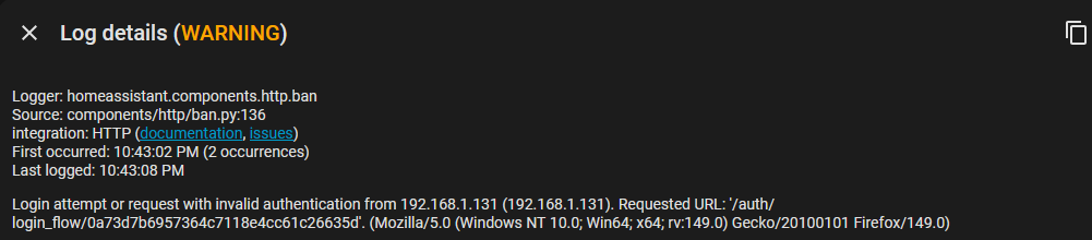

I am trying to log in on my phone with the Home Assistant App, but it never connects. When checking HA on my PC I see a log saying this:

The text says your username or password is wrong and your device might now have been banned.
Remove the ban and check username and password.
