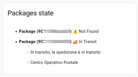

If anyone is still struggling, this is what works for me:
Add this template sensor (mine in in templates.yaml included in config.yaml included via template: !include templates.yaml)
# 17 Tracks integration sensor
- triggers:
  - trigger: state
    entity_id: sensor.17track_delivered
  - trigger: state
    entity_id: sensor.17track_in_transit
  - trigger: state
    entity_id: sensor.17track_not_found
  - trigger: state
    entity_id: sensor.17track_undelivered
#  - trigger: state
#    entity_id: sensor.17track_alert
#  - trigger: state
#    entity_id: sensor.17track_expired
#  - trigger: state
#    entity_id: sensor.17track_ready_to_be_picked_up
  actions:
    - action: seventeentrack.get_packages
      metadata: {}
        config_entry_id: YOUR_CONFIG_ENTRY_ID
        package_state:
          - delivered
          - in_transit
          - not_found
          - undelivered
#         - alert
#         - expired
#         - ready_to_be_picked_up
      response_variable: packages_var
  sensor:
    - name: "Packages data"
      unique_id: packages_data
      state: "{{ packages_var['packages']|length }}"
      attributes:
        packages: "{{ packages_var['packages']  }}"
        #mode: single
And this is the Markdown card for UI:
type: markdown
title: Packages state
content: >-
  {% for package in states.sensor.packages_data.attributes.packages %}
  {%- set name = package.friendly_name if package.friendly_name not in [none,
  'None'] else 'Pacakge' -%}
  - **{{ name }}{{ ' (' ~ package.tracking_number ~ ')' }}**  {{ '🚚' if 'in
  transit' in
      package.status|lower else '' }} {{ '✅' if 'Delivered' in package.status else '' }} {{ '⚠️' if 'Not Found' in package.status else '' }} {{ package.status }}
  {% if package.info_text not in [none, 'None', ''] %}
    - {{ package.info_text }}
  {% endif %}
  {% if package.location not in [none, 'None', ''] %}
    - {{ package.location }}
  {% endif %}
  {% endfor %}
And this is the result:
