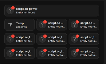

Trying to make a grid with modifications
This is what I have now.
There’s the yaml for it below
What I want is to take the middle spot in the first row and make it twice as wide. then shift everything over in the grid.
Desired Result: first row has one normal button, one wide one (the one in the second position). the rest of the rows are rows of three

That actually renders something. It renders it as two rows, not what I want but at least it renders something. I don’t need it to be nested, it didn’t work when it wasn’t. But it sort-of-works when it does.
Any suggestions?

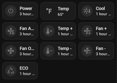

I assume this is what you described
Pretty darned close. I’ll try it tomorrow afternoon, if that works I can get where I need to. :slight_smile:
Let me know!
Thank you, that worked!
