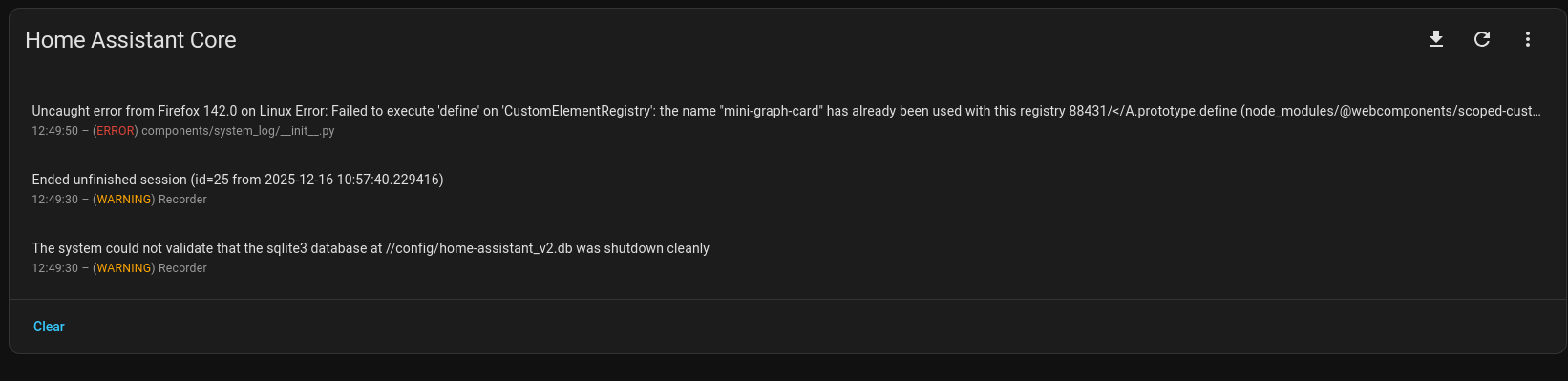

Check Settings → System → Logs for errors related to this entity.
Ah, right, thanks.
Ah, I see. When the sensor was unplugged, they both showed unknown. Now the sensor is plugged in, it shows the last reading for the temp, but not the humidity. Gotcha.
I cant see anything in the condensed log. Did a search for humidity in the main log.
So, when i go into MQTT, it can still read the data when i tell it to listen.
So, the data is getting to HA. what next please?
