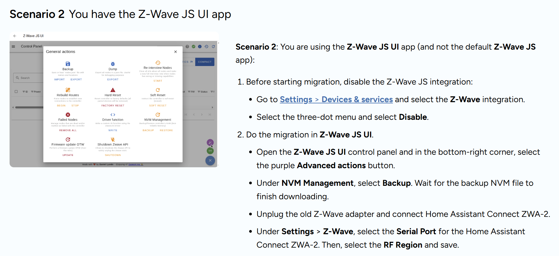

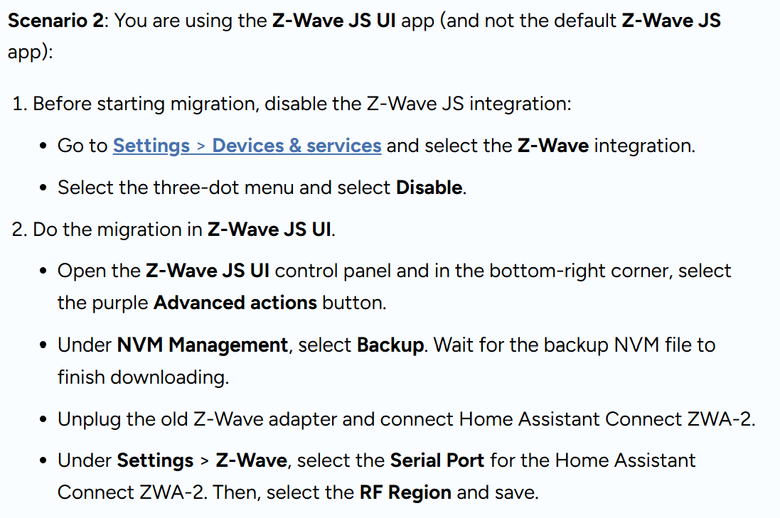

I’ve been following the steps in “Scenario 2 You have the Z-Wave JS UI app:”

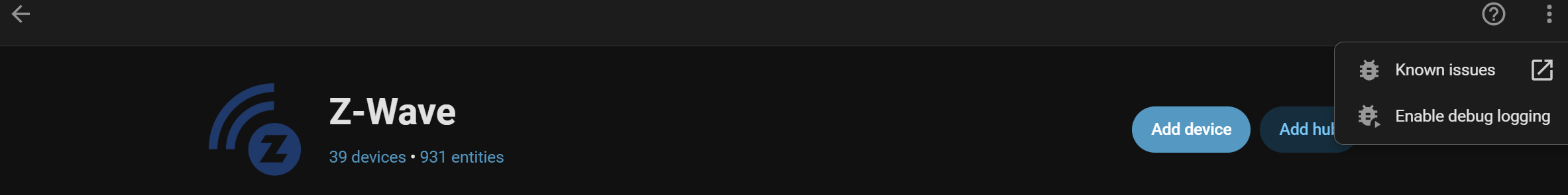

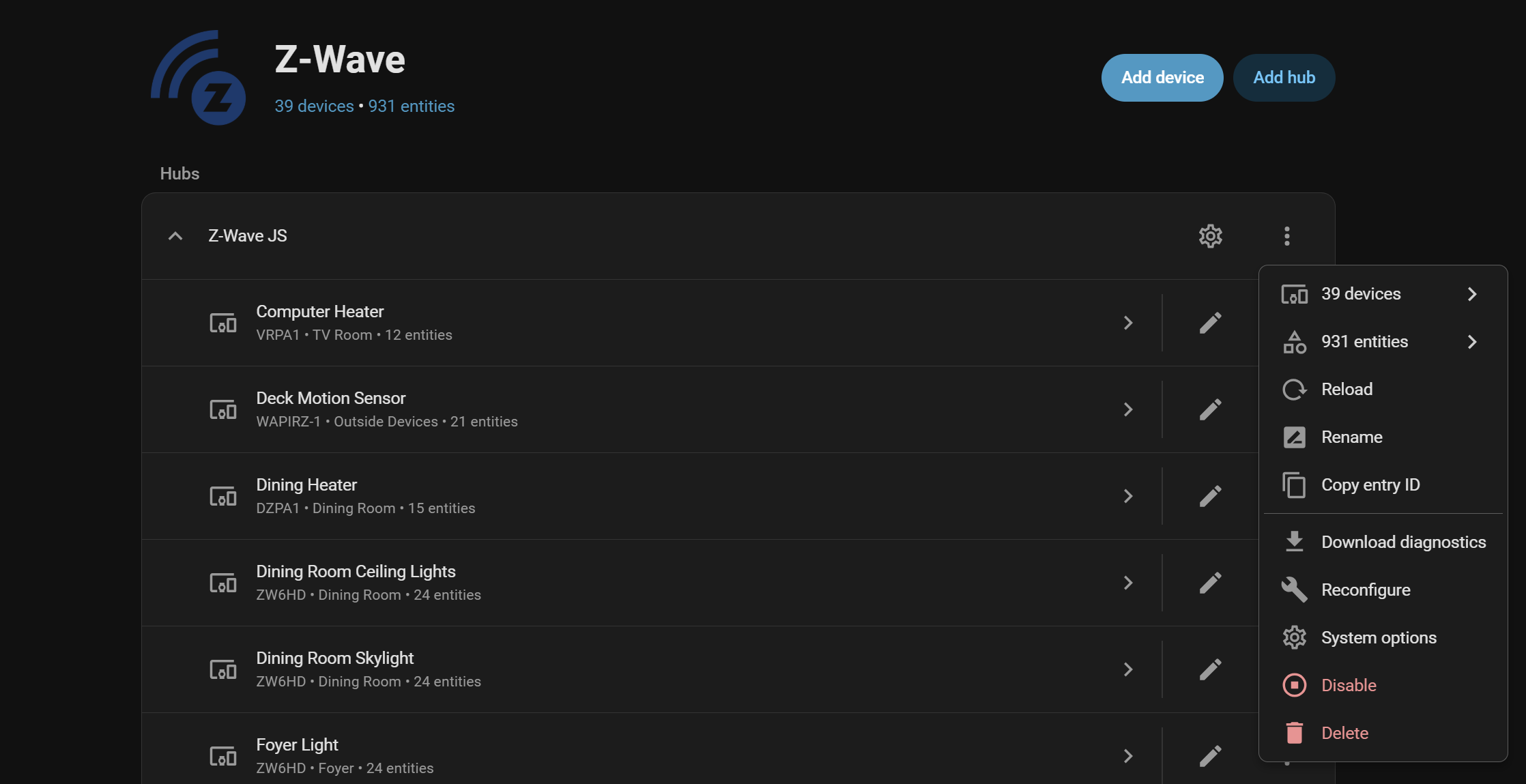

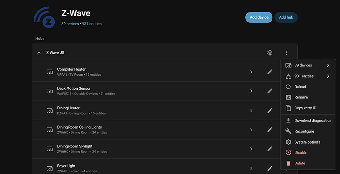

First concern is in step 1. The three-dot menu does not have a “Disable” choice.
Should I be selecting “Disable” from this three dot menu instead?

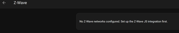

If I do, then after backing up the old ZST39’s NVM and plugging in the ZWA-2, I can’t get it to connect to HA. The ZWA-2’s light is pulsing white. The last step of the screen capture below shows the step I am trying to accomplish:

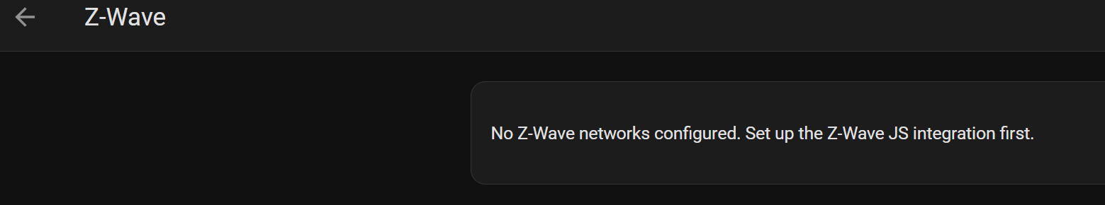

and here is what I see under main menu Settings->Z-Wave:
Any ideas? Thank you!
Step 2 is in the Z-Wave JS UI control panel, not in HA.
Thank you very much. The instructions were almost idiot-proof, but I exceeded them.
