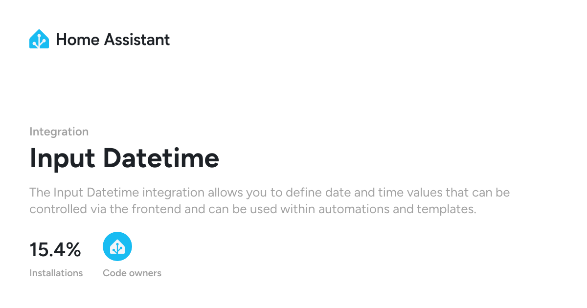

Have a look at the following docs:
Make two helpers: one for each time, and make them store times only, not dates.
Make an automation for each button to set them.
Make an automation for each helper using a time trigger to turn your lights on and off.
