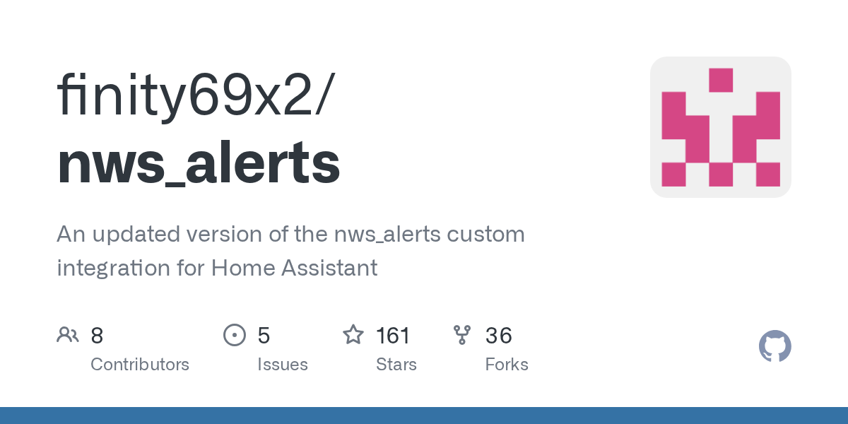

It’s from a custom integration:
You can find it in HACS.
The NWS has made some changes to their websites so I’ve updated the configuration instructions but I haven’t uploaded those to HACS yet so if you want to install it you’ll need to go to the github repo and follow the instructions there.

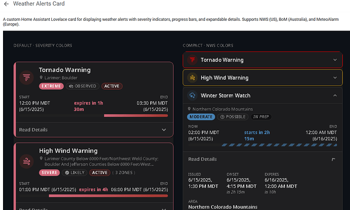

Can you tell me if this update will still work with the NWS Alerts Card?

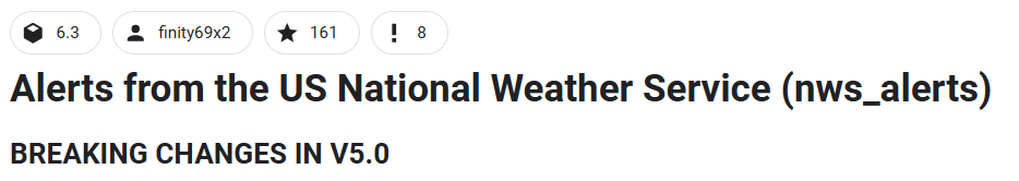

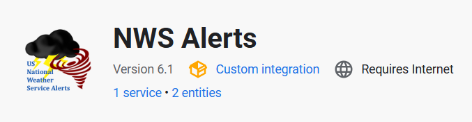

Also, my currently installed version of NWS Alerts is 6.1:
But in HACS it indicates that version 5.0 is available to install:

I don’t know of anything called a “NWS Alerts Card”.
there are examples at the github repo of things you can do to display the data in your HA frontend if you want.
If that’s what you mean then yes that will all still work. the only things that have changed (so far) are the instructions on how to find the codes to enter into the configuration. If you already have everything set up then nothing changes and you are good to go.
you are already on the latest version (so far) - V6.3 is after V5.0.
that blurb in the readme was put there for people upgrading from V4.x to V5.x since there was a major rewrite of the integration to make pulling data out of the attributes easier.
after I release the next update in a few days (don’t worry there won’t be any breaking changes in that one either) those update warnings won’t be in the HACS info and it’s already removed from the github readme.

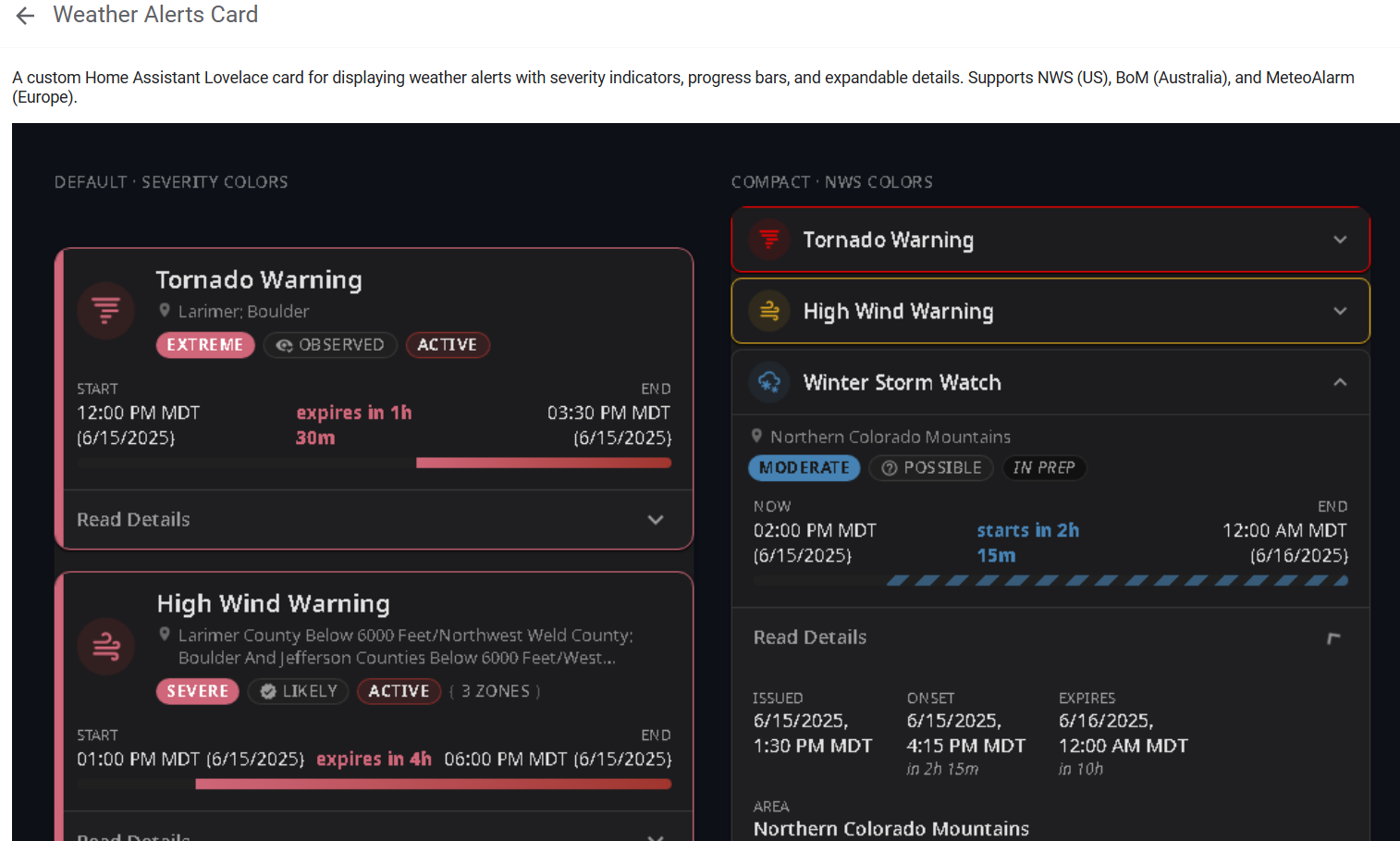

Thanks for the clarification! And thanks for NWS Alerts. BTW I’m using NWS Alerts Card from HACS. So far it seems to work well.
