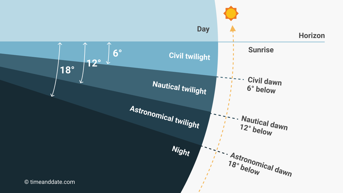

One of the reasons I prefer to use sun elevation :grin:
So basically:
sunset <= 0 degrees
sunrise >= 0 degrees
:wink:
