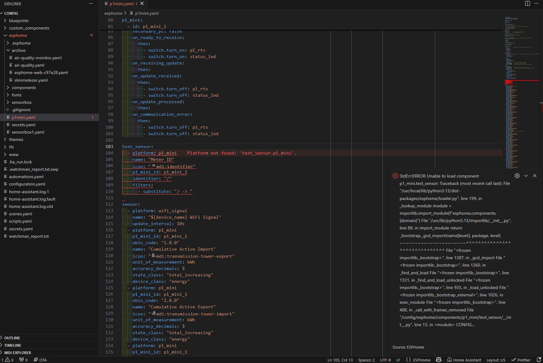

In Studio COde Server I get this also, why does it highlight the Platform row and give that error,
Also, “clean build file” or any other command or action results in same error.
