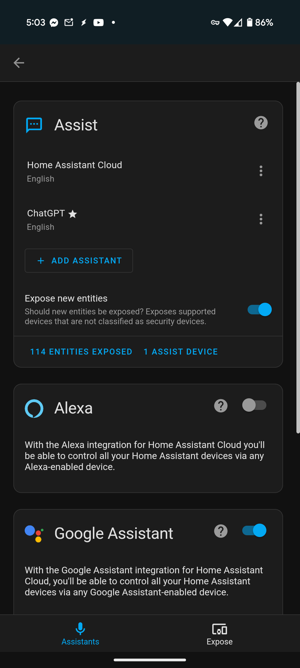

I have Home Assistant Cloud set as the preferred Conversation Agent (CA) and ChatGPT also listed.

This is what the Voice Assistant setting looks like.
I’ll show you ANY setting you want to see. I just don’t know what else to show you. I’m sure I’m missing SOMETHING but I’m at a loss as to what it could be.
