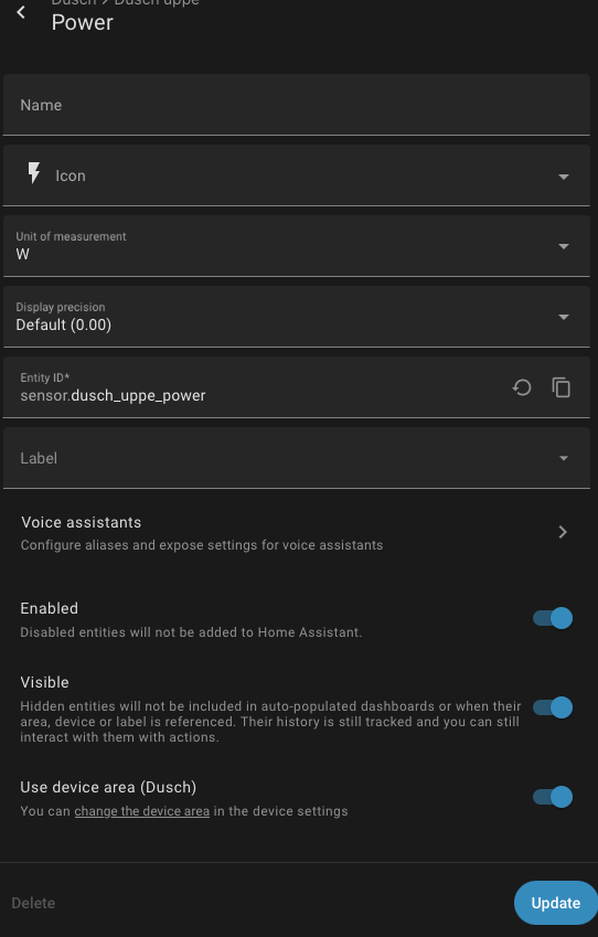

Creating it in Powercalc GUI does create a sensor but not values.

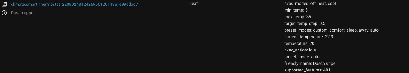

Developer tools, State:
PS can’t find a way to delete the sensor created in Powercalc gui that are not working .
