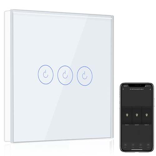

Looking similar (but is not quite the same)
They come in wifi as well as zigbee version
I have my house filled with this series (and use a couple of them ‘headless’ by means of a capacitor)
And they probably require custom firmware :thinking:
PS, if you need dimming, they also have that :grin:
Ah, unfortunately I need battery powered for this job. But it is useful to know that I can get a mains powered version that will (almost) match too.

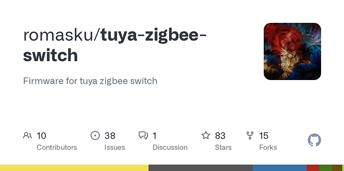

Regarding custom firmware: thanks @aceindy for the shoutout! I stumbled across this thread by accident.
Romasku’s firmware currently supports only mains-powered devices (namely switches and switch-modules), but you can check out adjacent custom firmware:
Sorry I don’t have any device recommendations, I only use switches with Romasku’s firmware and IKEA remotes.
