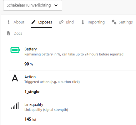

I am using zigbee2mqtt and have paired it. It is in the Devices list, I can see actions coming in (1_single, 1_double, 1_hold, etc.)
The integration has only 2 entities, Battery and Linkquality so nothing for the buttons.

I can see the action coming in, but how can I use it?
