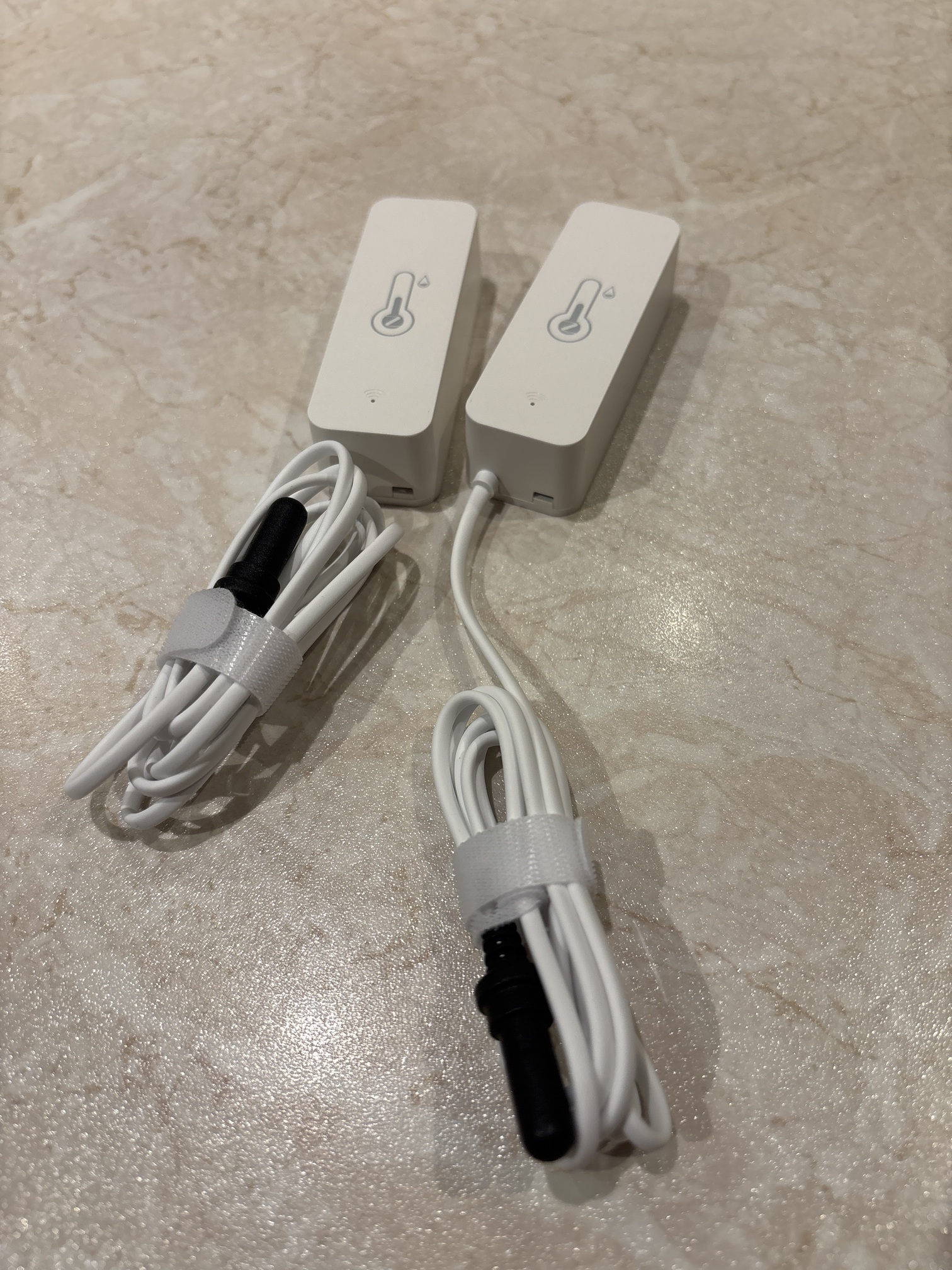

Hi, I got two of these temperature sensors with external probe for monitoring my fridge and freezer.
They are Tuya Zigbees and pair nicely with my ZHA controller, however, no sensor data is shown - just one firmware entity.
Device info says TS0601 by_TZE284_8se38w3c

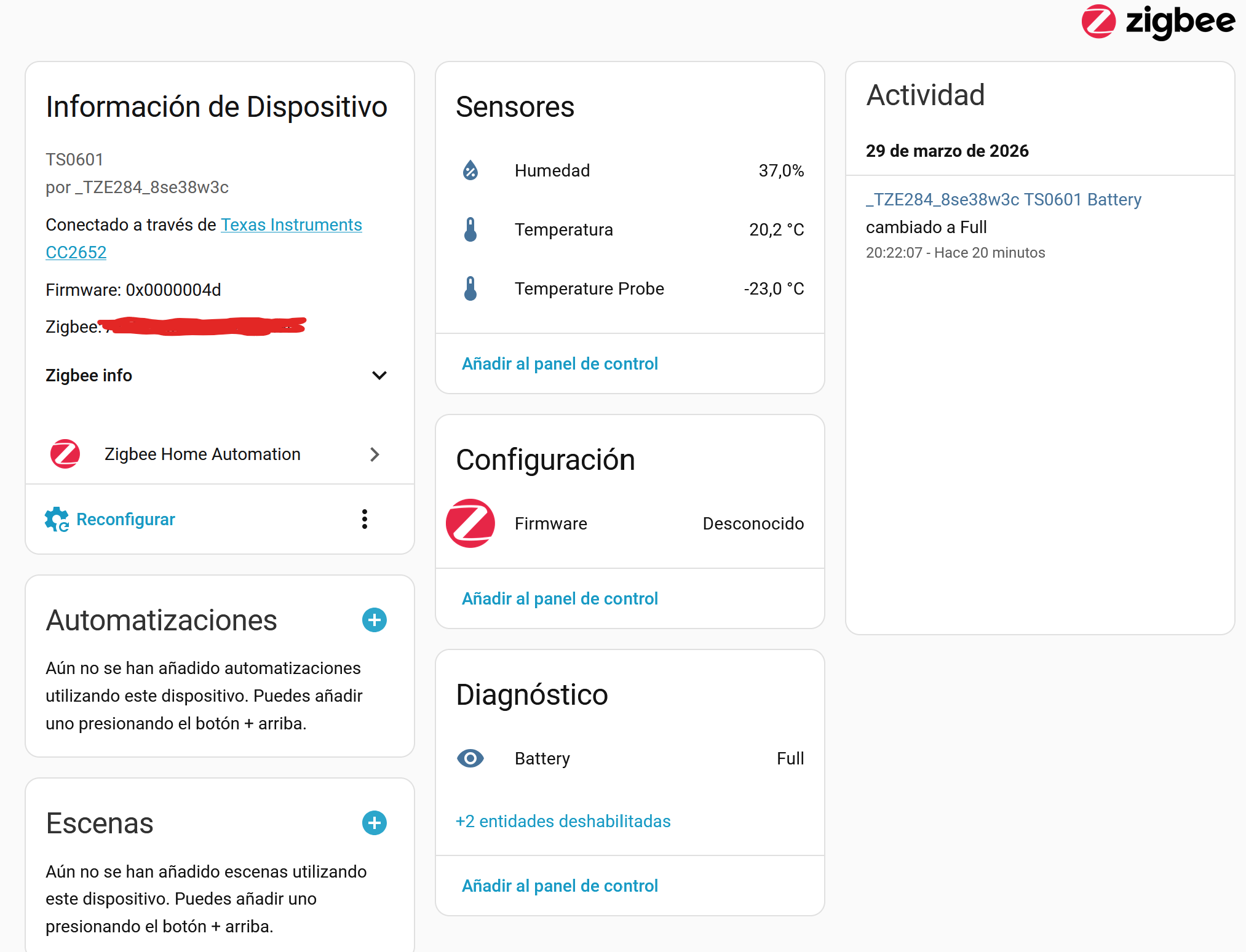

Did you ever get this working? Did you manage to write a quirk for it? I liked your issue in github but there’s another issue with a potential solution already - have you tried it?

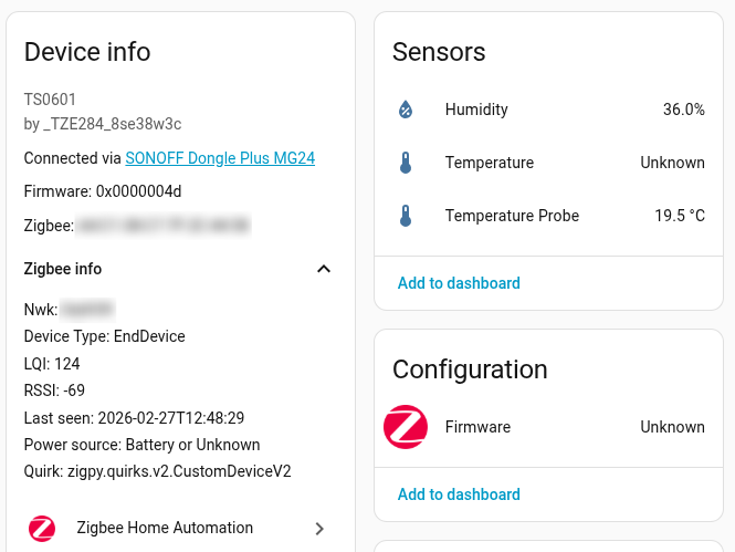

The other github issue with quirk has helped, I’m only getting the probe data but there’s two temperature readings and I’m only seeing one.
Hi, could you show your quirk?
Used the quirk found in this github issue.
Works fine as shown.
