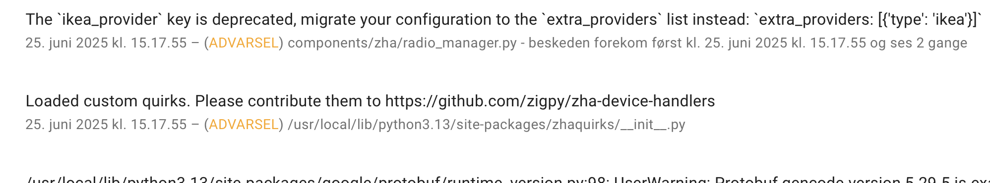

Do you see that in your logs?
Bildschirmfoto 2025-06-25 um 17.37.57
Yes, have same log.
I have several other quirks that are working, but this one don’t work…
What file did you update, the one you linked to, or the file knorian linked to?
Is it not possible just to post the quirk that work on your system?
