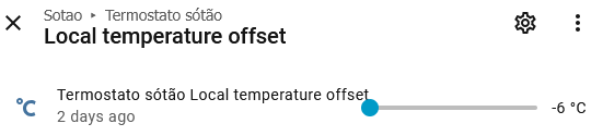

I have a bunch of these thermostats that work great in ZHA except for the temperature calibration. I can change (supposedly) the calibration from -6 to 6ºC but only in 1ºC increments. And when I apply 1ºC it only applies 0.1ºC.

This looks like the problematic part. If I change that min and max value to 6.0 and -6.0, the step to 0.1 and remove the type t.int32s would the problem be fixed? Or leave it as int32 but increase the max and min and use a converter. Or is this a device limitation?

In my calibration scripts I just take into account that the value is x10 and that is fine.
I copied the whole file to my quirks folder, is there a way to include only this change and leave the rest of the device description in the default location?
