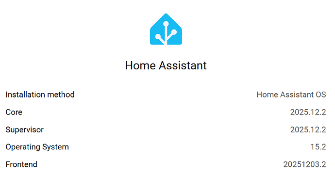

i just updated core and OS. the last time i updated was 2 years ago.

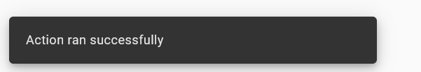

marked as successful but i dont hear anything on the speaker. for sure the volume is at max.
any idea why it’s failing?
I think that’s probably the main issue. Lots of breaking changes since then. Heck, the last update hosed a bunch of template sensors due to syntax updates to jinja2 templating.
