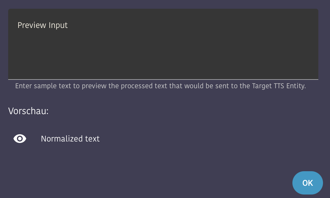

As the displayed text in the Assist chat won’t change, only the spoken text,
it’s not that easy to see why something sounds wrong in case of problems with this integration.
You can grab the response from your LLM in the debug view of the Voice Assistant,
then paste the text into the preview field of the tts-proxy config dialog:
Might also be handy to just manually test how it reacts to specific cases.
