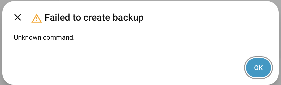

Was on vacation and my Tubez coordinator stopped working. Not sure what the issue is. I’ve unplugged/replugged the device’s power and ethernet cables, even tried a different port.
I have link activity but nothing is showing up in my router though. I’ve tried to do a backup of ZHA but it fails:

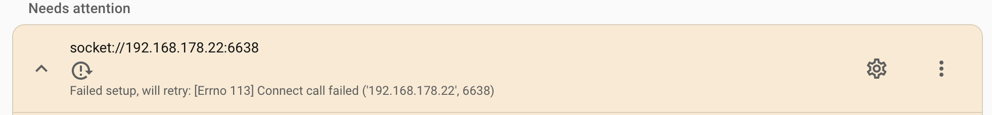

HA doesn’t see the coordinator so I get a loop of this:
Question: how do I not have to re-add every device back in if I can’t do the backup AND is it safe to open the coordinator and do a BSL (factory) reset?
At least one of my devices (was working) is unreachable so re-pairing might be a VERY BIG deal.
Help?
Can you ping the coordinator on your network?
Are you using a static IP or DHCP?
No. I am using a static IP but no I cannot. Doesn’t show up int he router either.
Is it PoE powered?
Can you tell what the PoE power draw is in your router
I’m using a USB to power the unit. Is it potentially POE and that’s why it’s gone?
Also, how can I backup the database?
No. Check your USB power supply.
Okay, I changed the USB power supply and now the Tubez is connecting to the router. Thanks.
