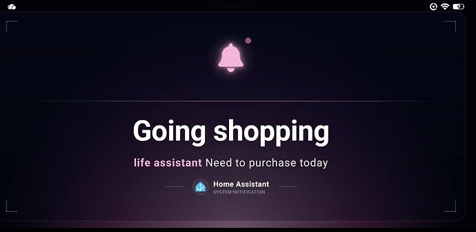

  • :bell: Notification scenes - Full-screen alerts for doorbell, alarms, etc.

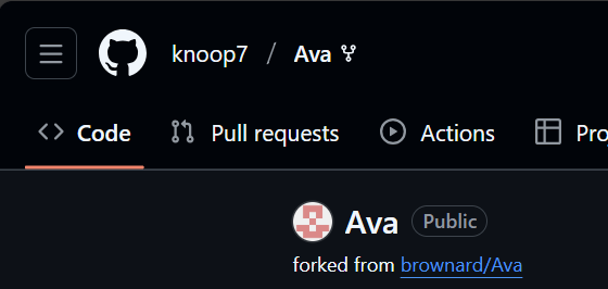

Thanks for the reminder, now open source
Thank you for the reminder that it is now open source, Home · knoop7/Ava Wiki · GitHub

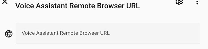

I have installed it, and setup regarding the documentation. I have entered the URL but how does the browser then gets started? When I start Ava I only have the “service” button to start/stop it and see the status (idle).
您可以看看悬浮窗时候开启,也就是说系统上层权限,同时去esphome官方集成中找到这个就可以输入
My Chinese (or the language you are writing), is not that good :wink:
I have put in the URL in HomeAssistant under → Settings → Devices Integrations → ESPHome → <device with Ava) and the Voice Remote Browser URL.
However when restarting the app nothing happens, it still keeps on the page with the service.

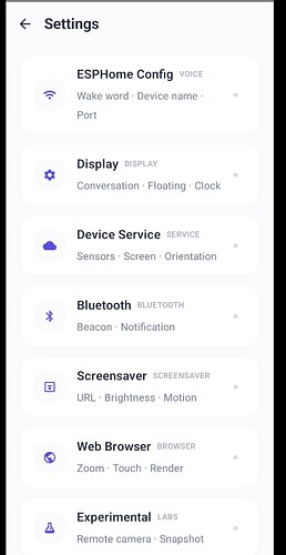

It is recommended that you check the permission problem, this is a floating window, it is possible that the floating window is not open, and the empty value is removed, such as after the gas switch is turned on, is it convenient to see the screenshot of your interface?
It is recommended that you check the permission problem, this is a floating window, it is possible that the floating window is not open, and the null value can be removed, such as after the switch is turned on, is it convenient to view your interface screenshots?
These are all featured
