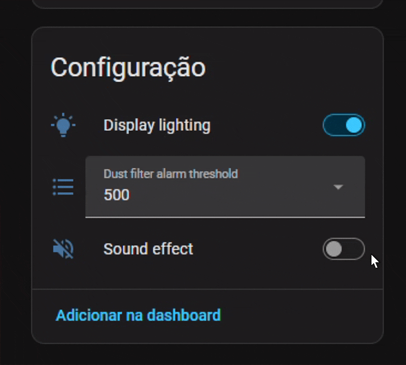

I'm using the integration with Samsung Smart Things; I can do this through the Samsung app.
Through Home Assistant, I can turn it on, turn it off, set the temperature, everything works except turning off the light.
