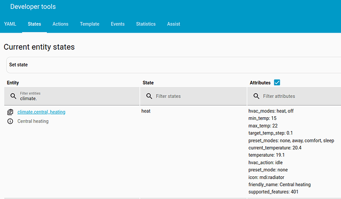

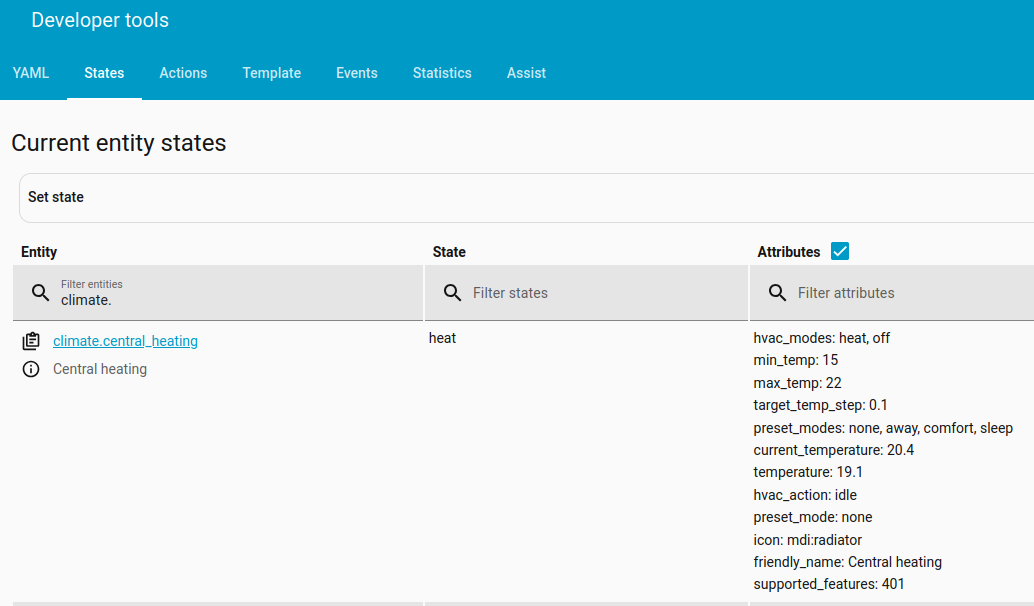

You’re looking at the list of hvac_modes. Please post a screenshot from Developer Tools / States showing state and attributes, like this:
If you can show it for TRVs in both conditions (asking for and not asking for heat), that would be helpful.

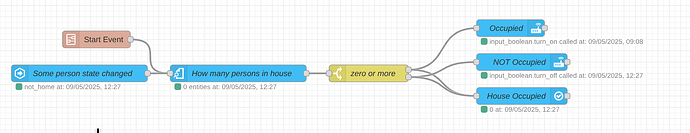

There are many ways to build this flow. As a starter, this is working for me in testing with a couple of A/C units. Please ignore the error flags on the nodes - I have edited everything to your sensor values hence it no longer works for me.
The flow starts with a trigger that fires for any ‘climate’ device state change. You can use regex here for simplicity, or you can add each TRV separately as a list if you like. When any one TRV changes state, the node will start the flow.
Then I use Current state nodes to find the current state of all the TRVs in series, and a Change node to add the found value of each (msg.payload contains either ‘off’ or ‘heat’) to a new message object ‘trv’ against the device name. At the end of the flow I have an object with all the current states in it.
A very simple JSONata expression "heat" in trv.* will test for “heat” in an array of all the values, returning true if so, or false otherwise, and a Switch node will direct the message to either the turn on action or the turn off action accordingly.
There are several ways to simplify all of this, but it should work once you have the correct entities.
Since the trigger may fire six times together at start up, I have added a rate limiting node just to stop the action being called too many times in succession.

Troon, that screenshot is exactly like mine
The attributes do not change in that page but I have been to another developer page and changed the text to ‘heat’ or ‘off’ and it controls the valve.

Then you’re looking for the state of the valve, not any of its attributes, and the template should be:
{{ states.climate
  | selectattr('state', 'eq', 'heat')
  | list
  | count >= 1
