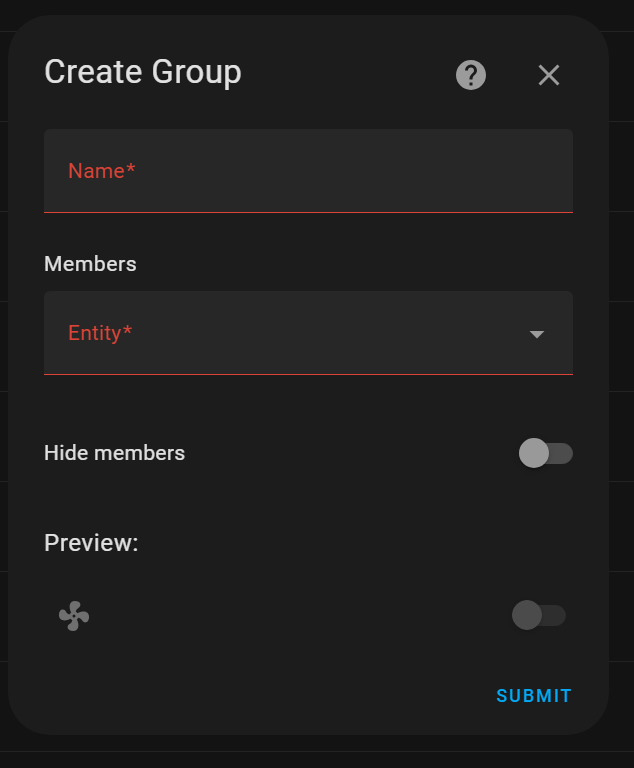

Have you tested what happens if you create a Helper Group called All Fans?

BUT when I try turn on all fans it does not run the two commands. It just responds with the text Turn on small fan Turn on big fan. It doesn’t actually do two “actions” of Turn on small fan and then Turn on big fan How do i force two actions within the system prompt? Is there a better way to do this in LLM? So far @LiQuid_cOOled grouping idea seems the most logical.
