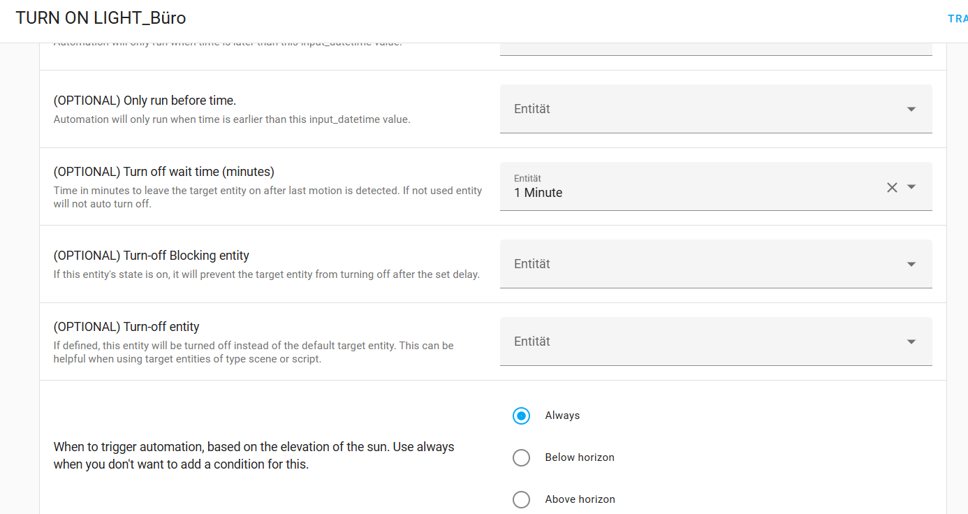

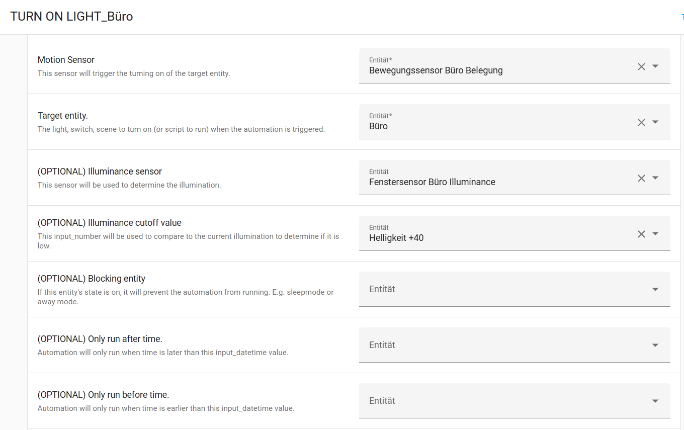

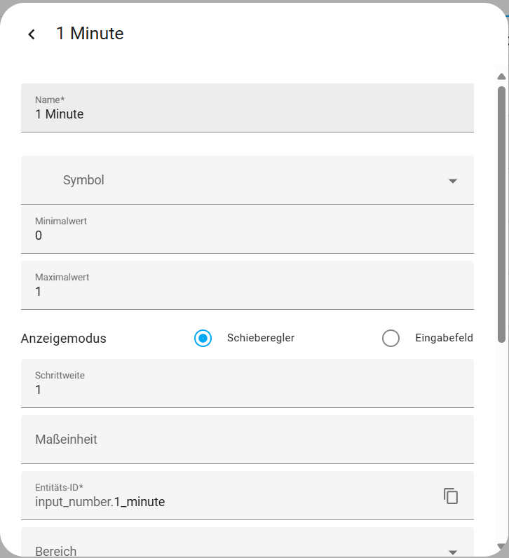

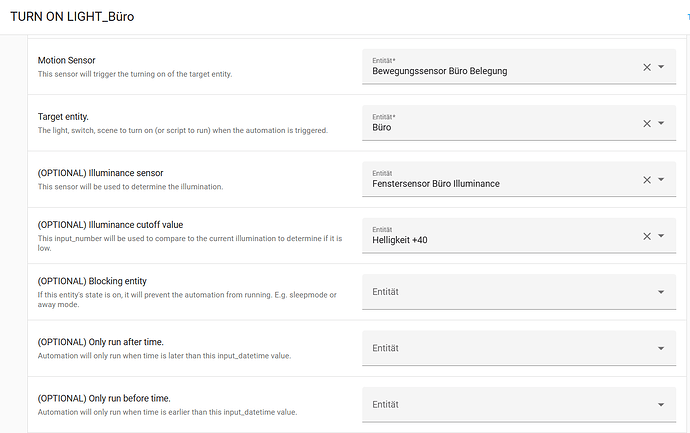

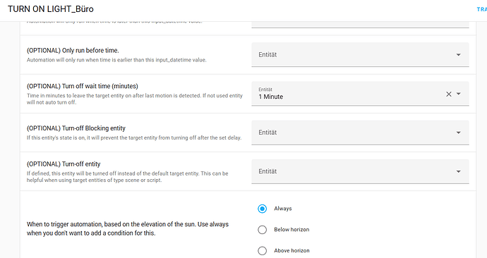

I would like the light to turn on when movement is detected and turns offafter a minute. I have created a number helper, but it still doesn’t work.
