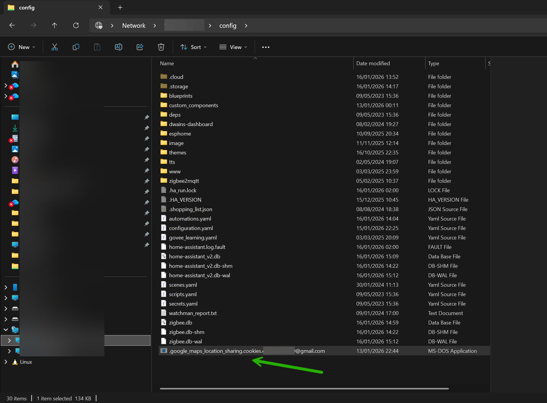

  1. Save the cookie file to your Home Assistant configuration directory with the following name: .google_maps_location_sharing.cookies. followed by the slugified username of the NEW Google account (account B).
  • For example: If your email address was [email protected], the filename would be: .google_maps_location_sharing.cookies.location_tracker_gmail_com.

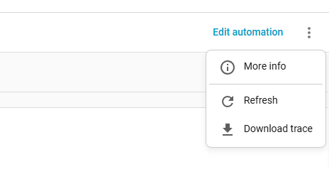

That is not a trace. That is your automation.
From the edit automation screen, go to Traces. Then, the three dot menu on the top right, click Download Trace. Open in notepad, copy all of it and paste here in the preformatted text tag.
thanks!

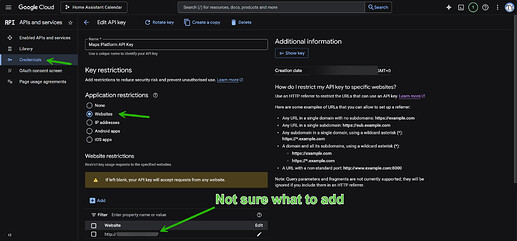

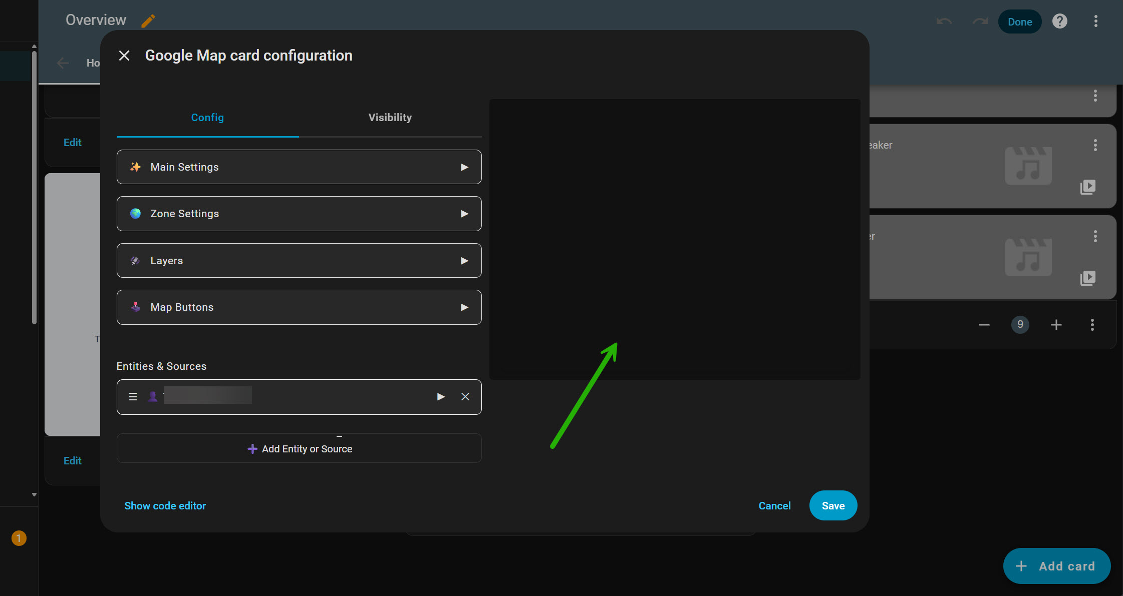

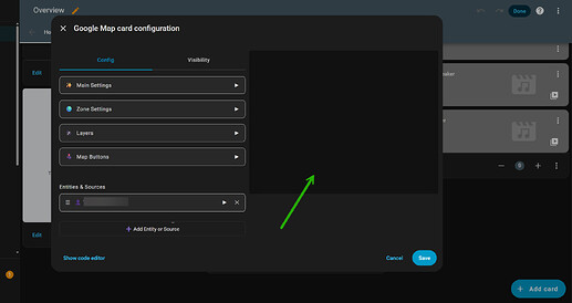

I also cannot get Google Maps into Ha either! It just gives me a black screen!
Not sure if that is to do with incorrect name of the cookie or the web site address in the API section to say what allowed or not allowed is also confusing me!
I will add a few images of the other issues I think might not be helping me get a fix to this.
For the cookie naming I have attempted!
[email protected]
For the bit in the API section of Google Cloud I’m not fully sure what address to add in? At a guess I added my home assistant URL Ip address.
And this is the Black Screen when I have added the API into it added me as a person into it, and added the Cookie to the root of Home Assistant.
Where I added the Google cookie that is suppose to go into root of HA
