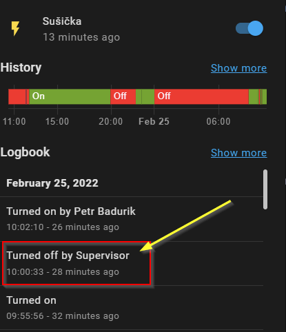

Hi Gentlemen, I am solving a problem with Shelly Plug S. I bought 6 of them and 4 of them work fine, only two (for Washer and Dryer) shut down spontaneously during the working process. All the plugs have the same FW and are also set up the same way.
All of a sudden, when I look at the status, they shut down. Then, of course, my wife comes running in and scolds me. The logbook says : âTurned off by Supervisorâ, nothing more. I could not find in any Log a record or reason why the Supervisor did this. Can someone please advise me ?

The âTurned off by Supervisorâ context.
