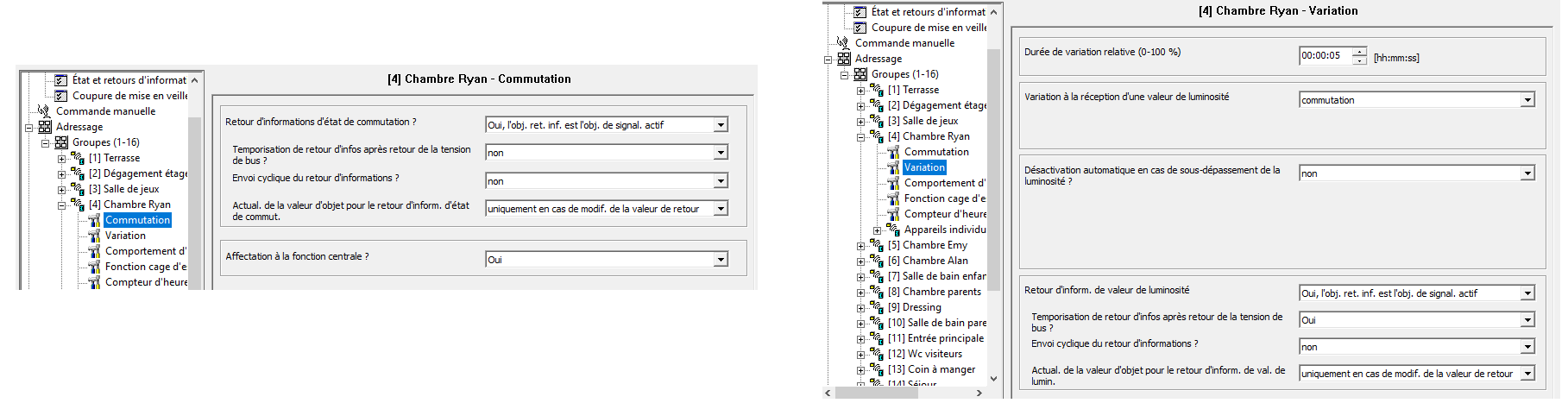

Hi !
It’s expected not to show as turned on when only a brightness state is received (not all Knx actuators turn on when a new brightness is set). You’ll have to configure your Dali gateway to actively send a on/off state (1/1/17) when it is turned on.
The problem is like riviera said in the top of the topic :
I’m able to control it from home assistant and from a KNX push button but when I turn on a light by using the dimming function (long press) on the knx button it keeps looking turned off in home assistant then with the light on, if I press the icon to turn the light on in ha, it immediately reports the right light level.
By turning it on with the on-off feature of the button it is reported as it should in ha.
Then its an issue with the Dali gateway. If there is no update for the % status when you use relative dimming then HA wont know it has been updated sadly.
If you use long press after that initial on, does it update then?
I think you didn’t understood the problem. It’s not the percentage who didn’t update. There is no on status message sent when i long press the physical KNX button. Only percentage message sent.
