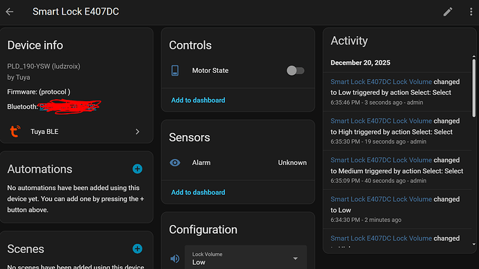

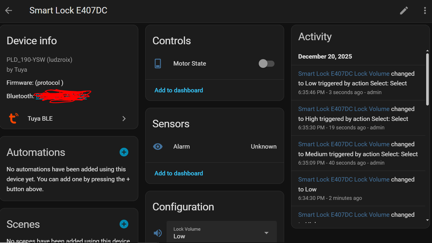

@Eugene-Musika Hiya mate I’ve just installed your fork as a custom repo onto my HA and managed to link my lock. However my clicking the motor state doesnt do anything. It doesnt unlock the door. You can find screenshots below:
My DP ID:
        "code": "bluetooth_unlock",
        "custom_name": "",
        "dp_id": 6,
        "time": 1766223671589,
        "type": "raw",
        "value": "AQE="
Tuya Dev Account Details:
### Device Information
Product Name: smart lock
Device ID: bfce4fybk39fiam7
Product Category: ms
Device Status: Offline
I use an esp32 ble proxy that is placed 1m away from my lock. My signal strength varies from -74 dBm to -83 dBm
I’ve noticed that it reports the battery correctly and changing the lock volume also works correctly. It’s just the unlocking part that isnt working.
Any help would be greatly appreciated :pray:
