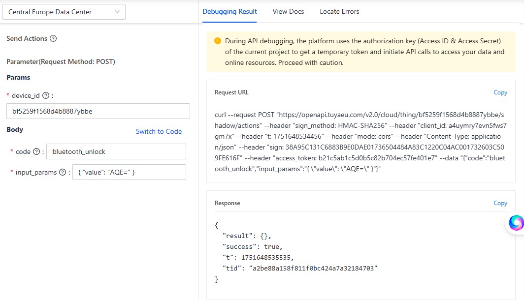

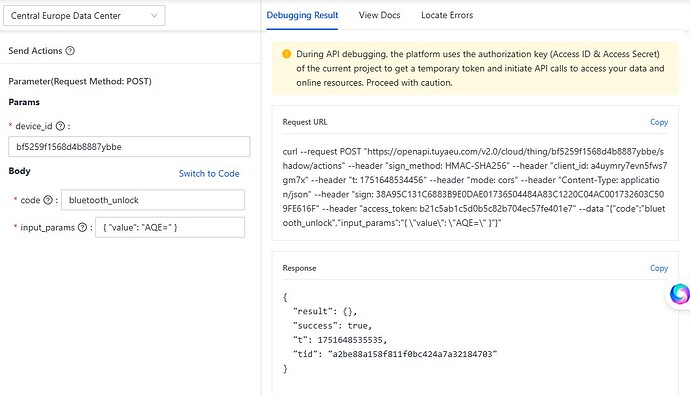

Your hint to use IoT Core => Device Control => Query Properties was a game changer at all. But i am not able to unlock the device from IoT. Do you know how we can unlock the device via IoT Core - Device Control?
This command does not what i want it does.

No, you can’t unlock it from IoT. Only from directly paired device. It’s some sort of security measure.

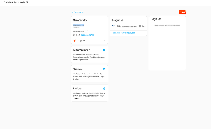

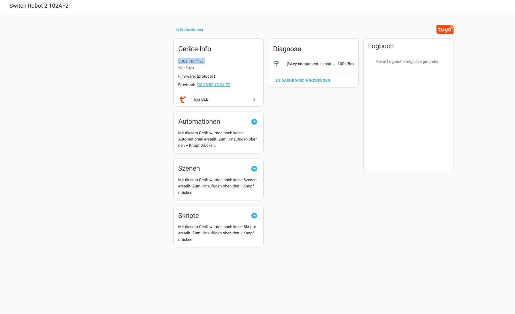

Hi, I try to get a new “Switch Robot” (SB02 (4ctjfrzq) ) to work.
I got it imported via Tuya BLE integration.
What do I need to debug where to find out how to kick the switch? Should be similar as fingerbot, right?
these are the results of api explorer device details:

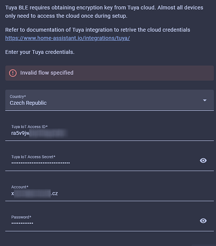

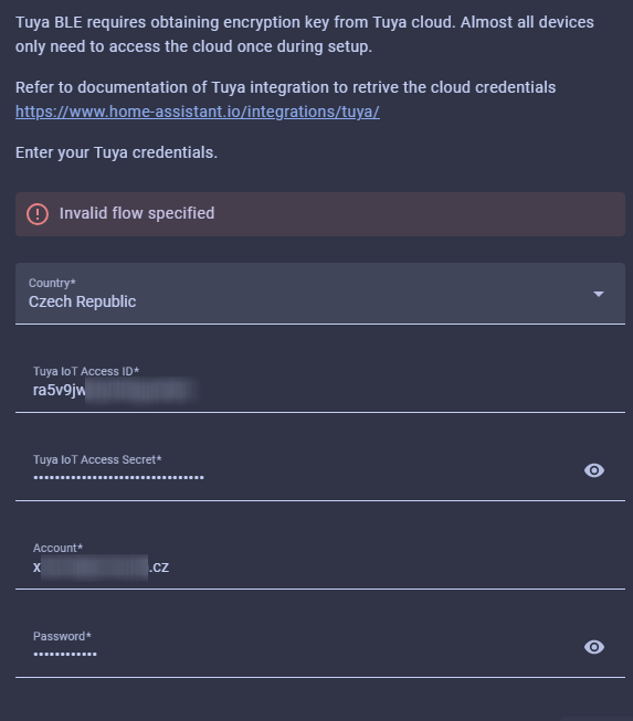

Can someone provide me some hint? I consider myself experienced user but I am not able to make the FingerBot Touch work. Not passing through adding the device.
I can see the BLE device in HASS, it is even recognized by the integration.
I created the developer account, link with Smart App and got the value.
But failing to pass with and “Invalid flow specified” error.
I am getting out of the idea, I found nothing usefull in HASS log.
okay, got it to work for the switch robot (product id 4ctjfrzq ) . it was similar to fingerbot plus.
What I learned:
  • Tuya is a mess.
  • I don’t need an ESP32 bridge or something similar.
  • I already had a bluetooth dongle on my home assistant installation (due to some other bluetooth sensors that were easy to integrate). So Xiaomi is easy and tuya complicated.
  • zwave and zigbee are always easier to integrate if you have the first of them running.
  • put it into your tuya smart app first. then it will be found locally and can be spoken to locally.
  • it seems like thie tuya BLE disturbs some other components that are without this integration running fine. This is in my opinion a big no-no.
  • Learn how to use the api portal / developer portal of tuya and you can find all the DP ids that you need to understand how your device works internally.

I managed yesterday evening to connect.
The problem was not Tuya portal but somehow the Bluetooth connection. I let the device for a while off charge just on battery, then connect again to USB and it passed.
So now I can see the Fingerbot Touch in HA but of course only signal strength as the device is not supported.
Once I have some time I will try fork the repo and maybe I will find a way how to add it.
