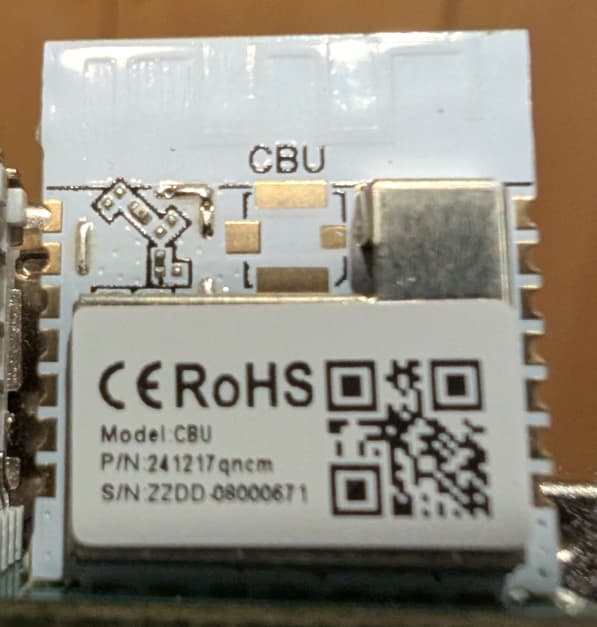

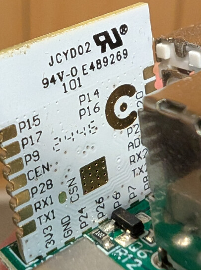

You obviously took it apart to identify it had a Beken chip. Did you happen to take any detailed photos of both sides of the circuit board? Clear enough to identify the part numbers. Post them here for interest
Not sure which Beken chip it is inside the unit, but OpenBeken (a Tasmota lookalike for Beken chips) and ESPHome will support most of their chips.

  1. It was an educated guess, I did not actually check if it was Beken because all Tuya devices from aliexpress were Beken for years now.
