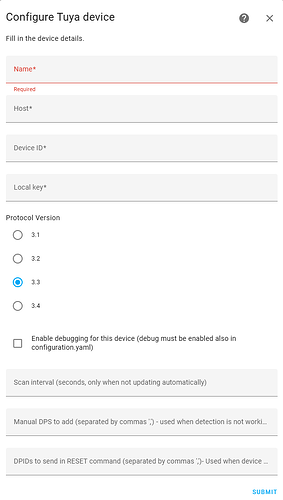

If I try to manually configure it, how would I know the protocol version to be used? I could find no clue on that.

Quick update. I now use a fork of the localtuya integration. This one has a protocol “auto” version and it works fine for my plug. It detected version 3.4, so probably it would also work with the “original” localtuya, I guess.
