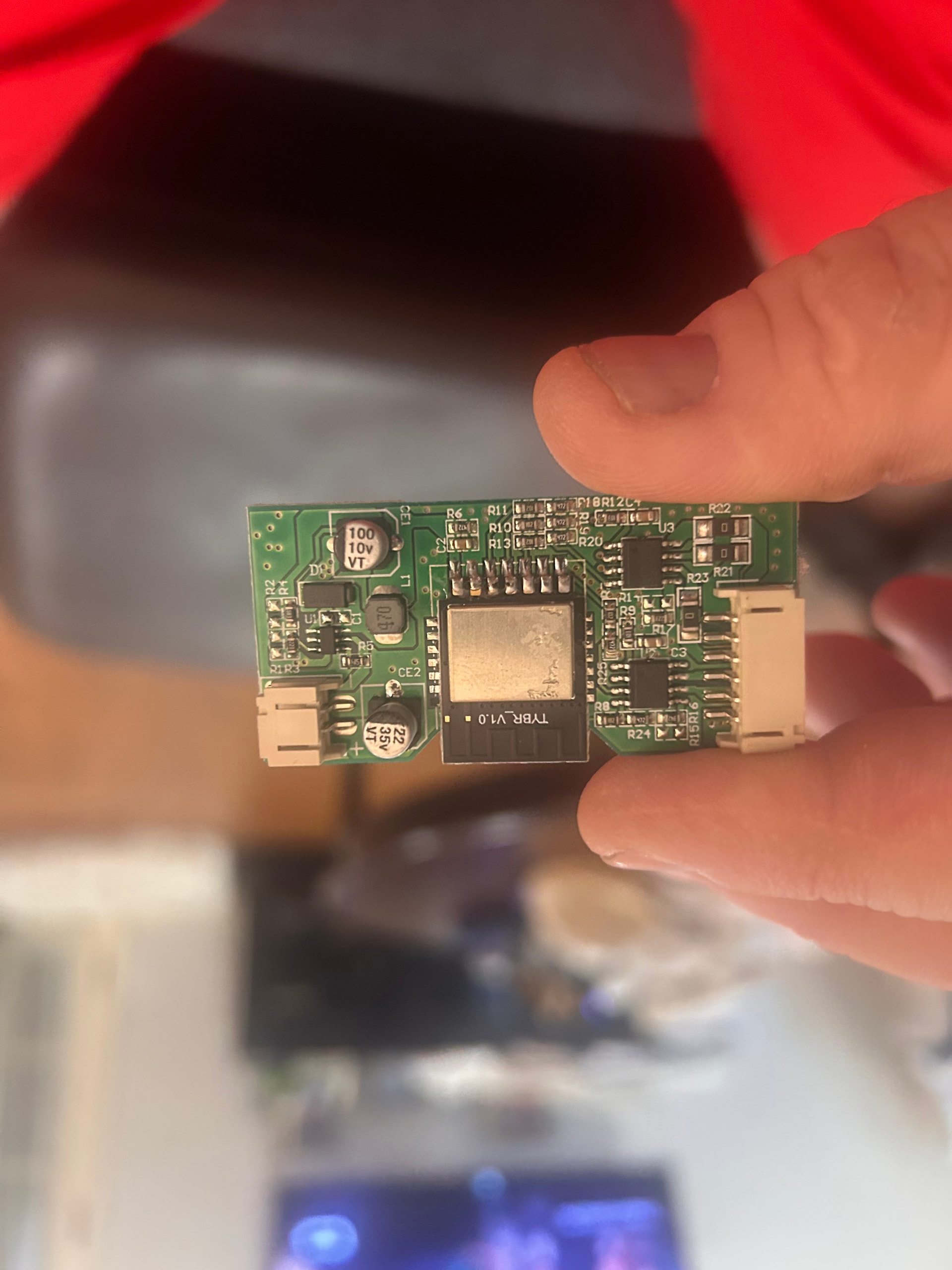

Are they wifi or zigbee? Any part number for the lights or that little hub?
If they are zigbee I would simply connect them to a zigbee dongle and zigbee2mqtt instead of their hub and app.
If they are wifi, they probably use a W2BL board with a Beken7231 chip and can be flashed with ESPHome (libretiny), I have 4 tuya wifi recessed light and flashed esphome on it, working 100x better now

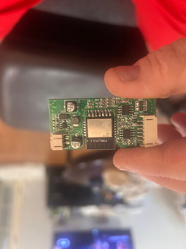

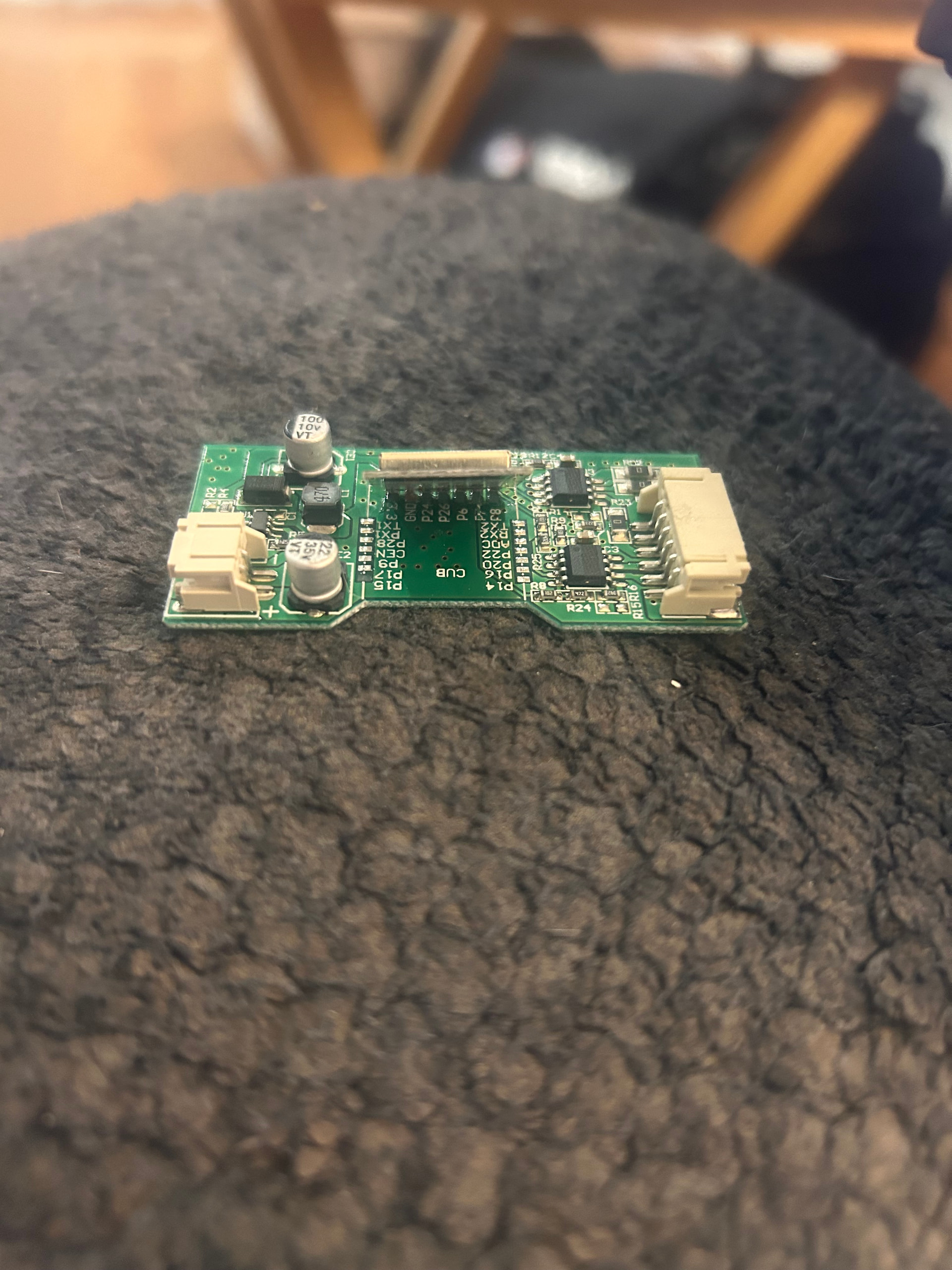

Here is a pic of the board inside the light. The lights I think are bluetooth that connect to the little hub.
