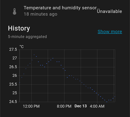

Hi, I’ve started trying to move some Tuya devices from the standard Tuya integration to Tuya Local (using GitHub - make-all/tuya-local: Local support for Tuya devices in Home Assistant).

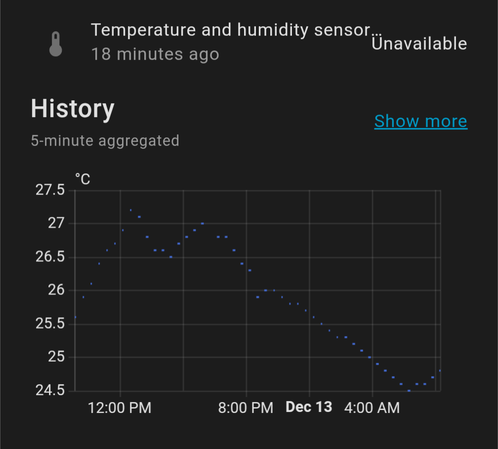

The first device I tried is a Wi-Fi temperature and humidity sensor. But the device is always unavailable unless it is currently updating its values (it was set to update every 30min in the Tuya Android app).

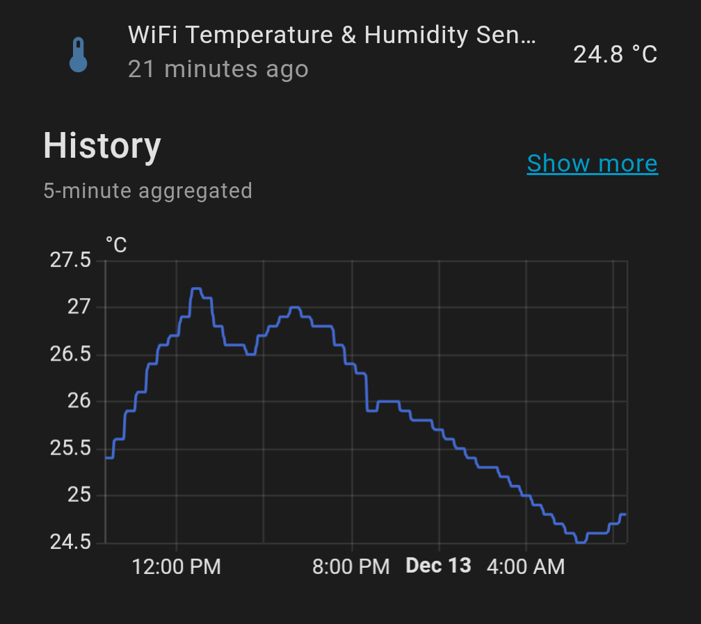

It worked fine in the standard Tuya integration. Is there any way I can get it to work the same in Tuya Local?
Tuya Local integration
Standard Tuya integration
You can always use vlans for cloud devices.
I mean theoretically you can and basically you should.
Tuya local will not solve this problem. And the problem is that you are using cloud based devices in your local network.
