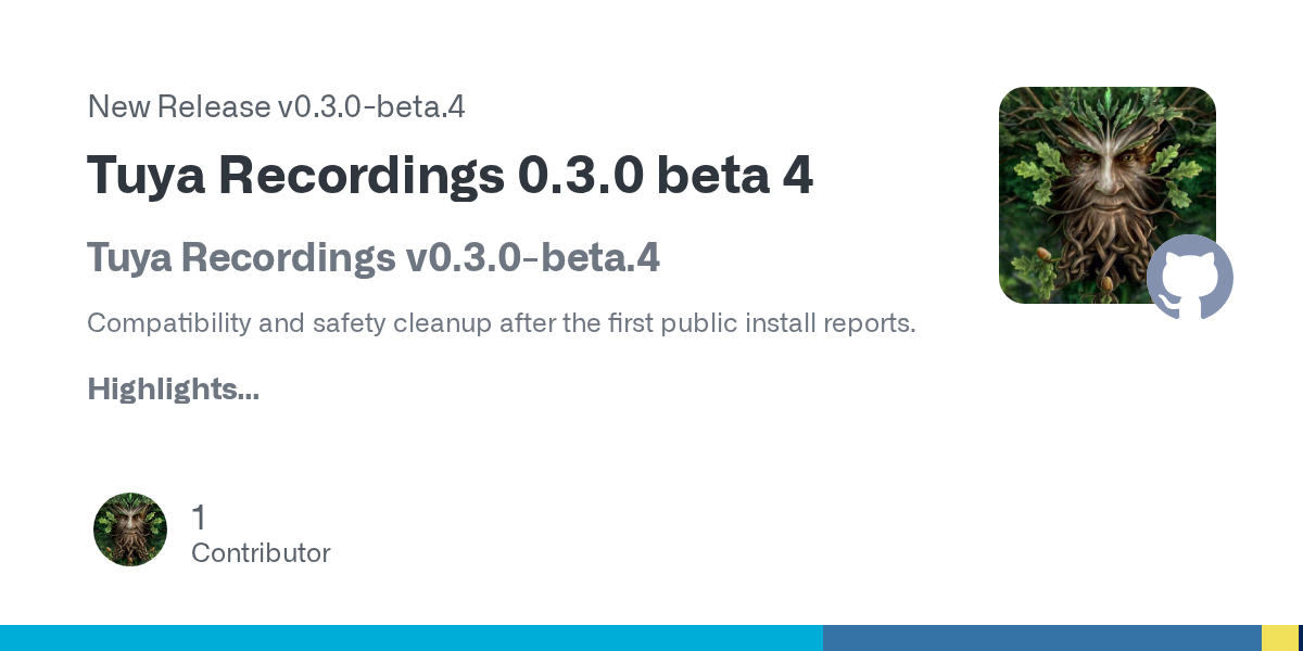

You were right: this was a bug in my config flow schema. The media storage path field was using a custom Python validator directly inside the form schema, and Home Assistant 2026.7.x could not serialize that for the frontend. Pre-creating /media/tuya_recordings would not have helped because the crash happened before the form could even render.
I’ve fixed this in v0.3.0-beta.4:
The storage path validation is still there, but it now runs after submit and reports a normal field error instead of breaking the config flow.
Please update through HACS, restart Home Assistant, and try adding the integration again. If it still fails, please open an issue on GitHub with the new traceback:
