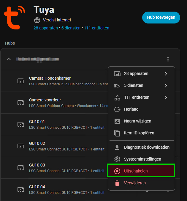

Oh wait…I tried to ‘shut down’ the initiate sync (Im using my version in dutch)
After that I shut down the HA and restarted it.
After that I reopend the Tuya connection from Settings > devices > integration > and started it again
Now its working. Without the ‘scan’ part. Just like that.
