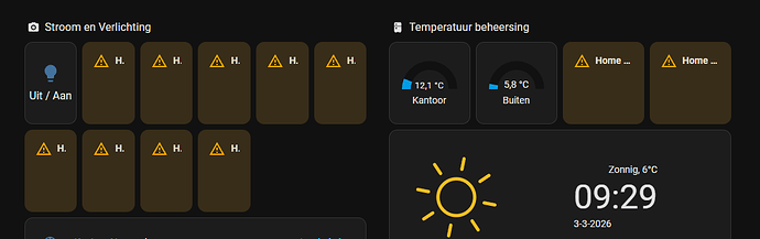

Nevermind… still not working properly. I could connect my lights again after my last post (so it was not just cached from my browser), but suddenly they stopped working and when I went back, it was again ‘initializing’ and my dashboard showes up like this
– edit
Iam new to this website so I did not know yet I can only post 3 reply’s in same topic. Sorry for that.
What I have found out is that there is somehow a big latency on the line. Once its connected again like I described above, and I click some of the tiles on my dashboard, nothing happens… after a while (couple of minutes) then suddenly it apears to happen (turn on light, turn off power heater)…
– edit 2:
I even tried to reinstall Home Assistent on another VM, back loaden an backup from 2 months ago and tried it again.
Same issue. So I guess something is wrong with the connection between HA and Tuya itself somehow? Anyway… #dev @DevSK @someone hehehe…
– edit 3: I tried to install Homey on another VM just a couple of minutes ago… and then I tried to connect to Tuya… Same issues… So its not only HA based… The problem is at Tuya somehow…
